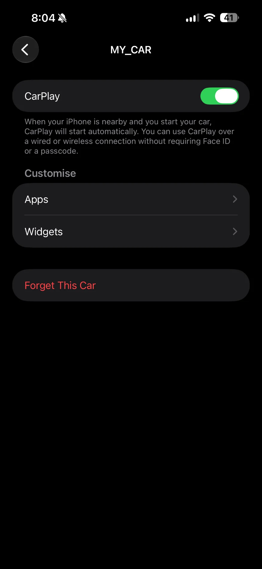

Turn this toggle on and off instead of removing carplay / wifi.
