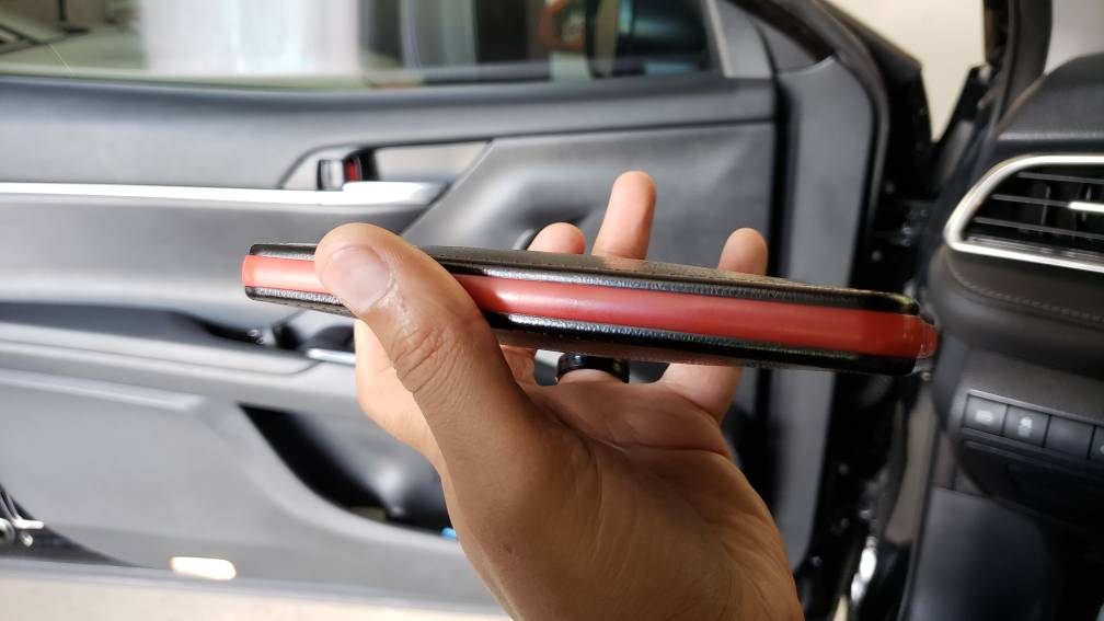

This is what a battery bank can look like siting in a car. This was in my wife's car and it was in a the center compartment. Granted here in San Antonio, TX the temperatures are the kind you dance with the devil at the moment. Notice the bulge in the case in the middle.

If that power bank was in an enclosed center compartment in a hot car, that probably contributed to the battery's swelling. When it gets really hot out I put my power banks under my seat in such a way as to allow air to circulate over them. I crack the windows open a bit and also have a thermometer in my vehicle and keep an eye on the temps. On a few rare occasions on very hot days I've taken the banks out of parking mode service until I am under way again with the air conditoning on.
