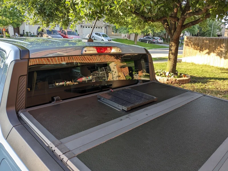

I'm currently testing a 30w panel with 12v regulator / flooded battery charger. Planning on leaving it on the entire week and not driving the car, and then sampling the battery voltage at around 10pm each day. No dashcam load yet, just to see if it's enough to compensate for the battery's own natural decay.

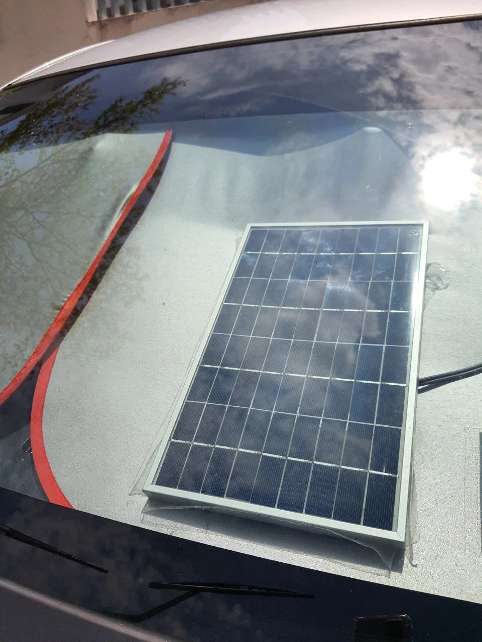

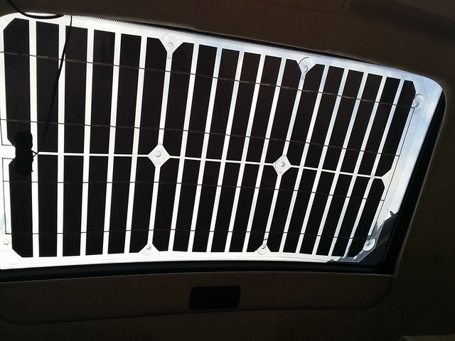

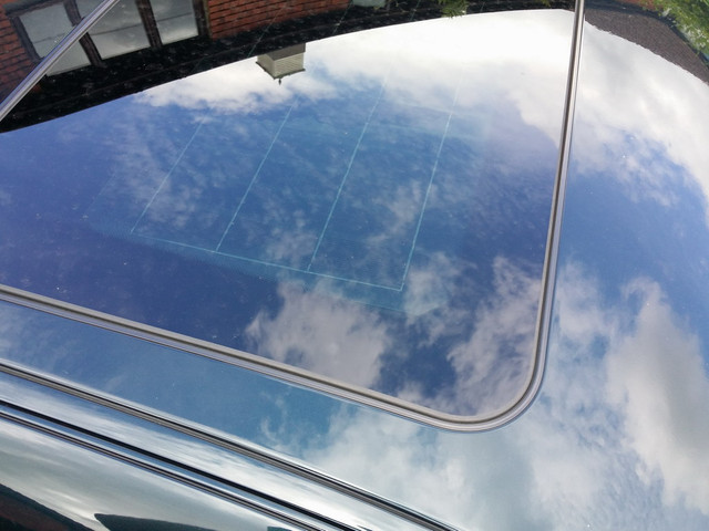

About 6years ago I have bought quite a large solar module (15watts) for the car to get extra electricity for the dash camera during parking mode, and unfortunately, that is more complicated and problematic than you think:
I have installed 15watt "Flexi" solar panel under the sunroof, which looks really nice, and a 15Watt panel fil well as on the picture, but things get more complicated with time, here is why:
- car sunroof glass has an invisible UV cut filter, and because that UV light is mandatory to convert light to electricity solar panel works extremely poorly (if was giving me just around 0.5W from 2Watt which typical dashcam needs). This UV filter is probably there to reduce heating car interior during summer and cut light which can cause damages to the car leather interiors.
- DC-DC step-down converter also generates some electricity losses which means that already very low power also is even poorer.
- with the time Flexi solar panel gets micro-cracks inside the structure due to car vibrations, which caused power drop to almost 0.1W (from 15W),
All project was a big failure, but here is some hope for others:
- make sure that your car glasses have no UV filter
- some car rear windscreens have no UV filter coat (and there you can place a solar panel if you really want).
- don't buy Flexi solar pannel types like mine, is poor and it will get cracks with time, some people recommended below Flexi type solar panels (this is different technology Flexi solar panel type, is stronger and shouldn't get cracks in cars),
but still, it needs a full light spectrum to provide good power, especially high energy light spectrum which is IR and UV.
- the best and the only one way to support dashcam by the solar panel is to convert power from solar by DC-DC step-down converter and connect to the same power line which going to your dash camera, just avoid charging batteries, power banks...that really doesn't make any sens sue to huge power losses, and a small amount of power to really charge anything apart support power line to the dash camera. the best DC-DC converter and the most efficient is that one:

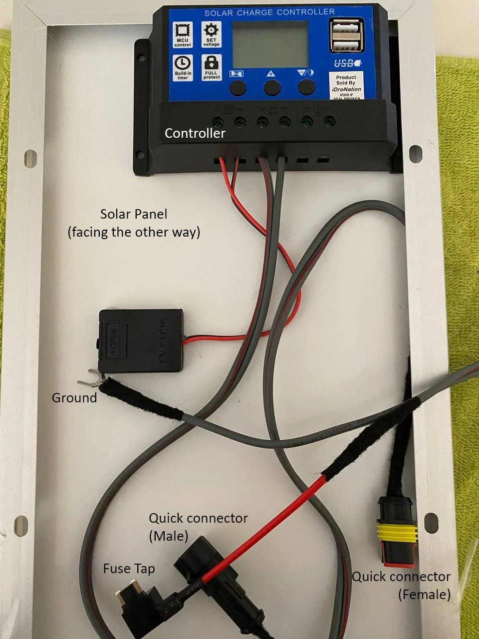

Anyway, this is my $15 setup that I'm testing out now (without dashcam load). Just monitoring to see if it's enough to sustain the battery voltage on a small car parked, and not being driven for 2-3 weeks at a time. Controller is set to float ast 13.7v, to turn off the load if voltage falls below 11.6v (that's the highest it can go), and to turn the load back on when battery is at 12.6v. At this point the load settings are irrelevant because there is nothing connected to its load terminals. The car battery fuse tap is connected to battery terminal of the controller. Technically when the car is not running, all the controller sees is the battery. Desulphication voltage is set to 14.6v, but I don't know what that really does because the manual does not describe any sort of routine for this purpose.
Fuse tap and ground are connected to fusebox as if powering a dashcam with parking mode. The quick connector is tucked away into the glovebox for easy storage and access.
So when the car is parked, I take the panel + controller glued behind it out and put it against the windscreen with the sunshade holding them up. The quick connector snaps to the other end from the glovebox, and away we go. I've left the car like this for 5 days so far, and I read the battery voltage via whatever being reported by the insurance company's telemetry device which gets updated about twice a day when the car isn't moving.
The car's battery is a paltry 34B19L, and the panel is rated at 30w (no-load voltage under direct sunlight at the hottest time of the day is 20.7v). On the first day, the voltage started out at 12.5v. 3 days later it's down to 12.2v (it had been raining every day from about 2~3 pm onwards, so there's only really hot sun from about 9:30am to 1:30pm). Let's see how long more the voltage can hang on at 12.2v.
At the rate it's going, I don't think this can sustain any sort of motion detection parking mode, or time lapse / low bitrate parking mode. Perhaps the sleep --> G sensor --> wake up --> record --> sleep sort of parking mode is possible to keep going for weeks/months on end. Perhaps a 50w panel would be able to do better, but the controller didn't regulate current and I didn't want the panel to be dumping a large current onto the battery, therefore I figured 2.1A maximum was pretty safe. Maybe 3.6A x ~40-50% efficiency might have been able to keep the battery's voltage higher.
By the time we get to 100w panels, it's taking up too much space already, and clumsy to move in and out. Will continue to keep watch and update if anything interesting happens.

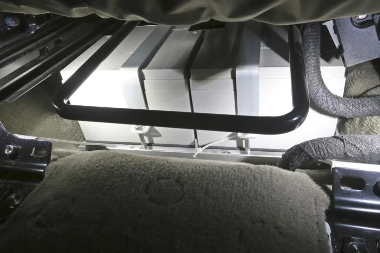

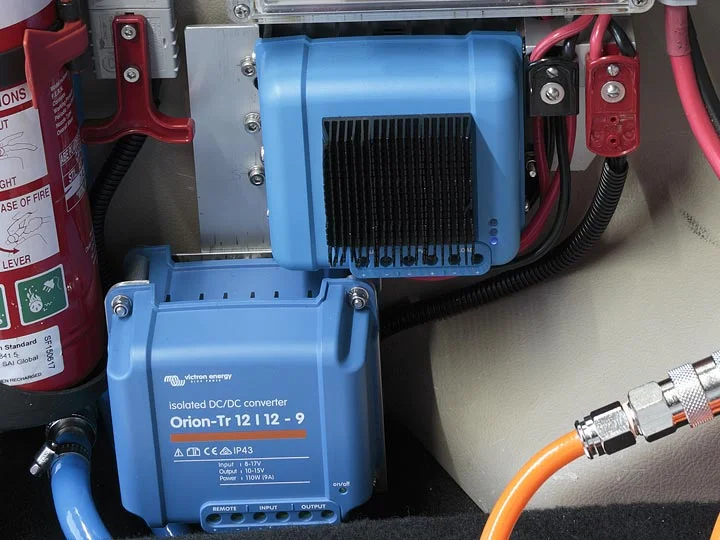

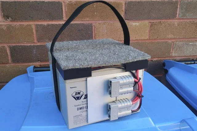

Most people use AGM batteries, I have used 4 x 26Ah gel batteries as these were the only size I could fit around the car. They are mostly for a small fridge & secondly charging phones etc. The fridge needs 15Ah per 24 hour. I have got a DC-DC charger to charge up when driving & use solar panels when camping longer. My Garmin 56 cameras just plug into the supplied 5 volt adaptor & that is supplied by the car or auxiliary batteries.
I really do recommend one gets information on the systems people have set up in motorhomes & caravans & do a scaled down version for the car. They is a wealth of information on battery setups, including lithium setups.
2 of the 4 batteries under a seat.

Solar controller (with additional heatsinks front & back) & two 9amp DC-DC chargers.
One 26Ah battery which is used in the car with the fridge or can be taken out if I take the fridge out. Or plug the phone in with adaptor for that matter.
Nice (y) And thanks for the pics. AGM is good, and less of a gamble than "B" grade LiFePO4 which is what is usually what the lower-cost ones are. With AGM you're getting new "A" grade for certain.

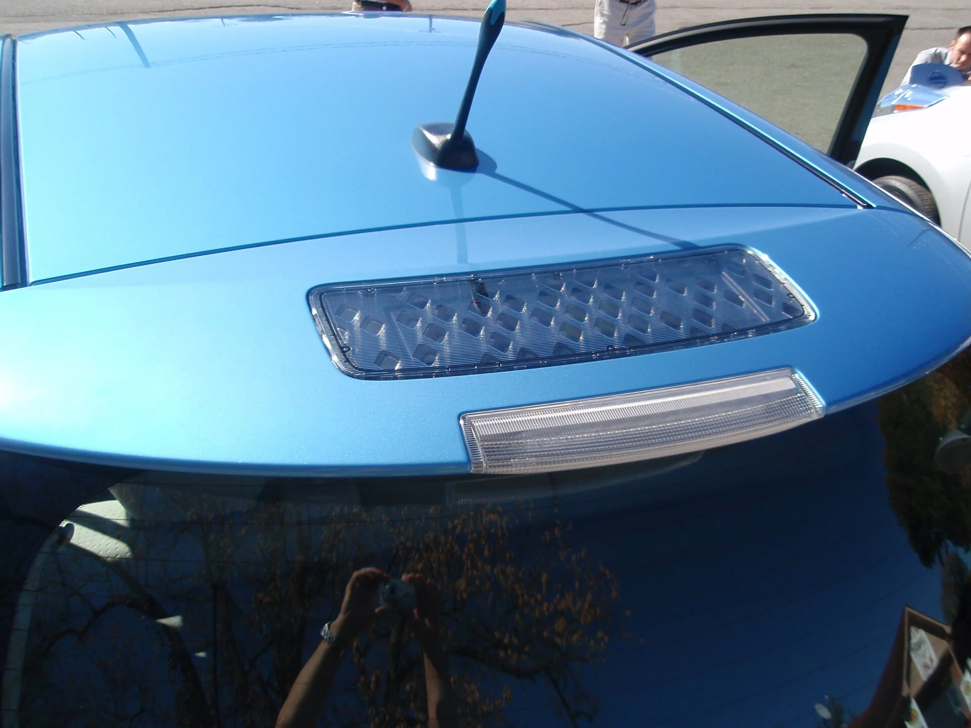

People have been racing solar cars since 1987 if not earlier: https://en.wikipedia.org/wiki/World_Solar_Challenge But race cars are not very practical!
Thankfully, a production solar car - a regular car for commuting, errands, family trips, etc, not a race car - is under development by crowd-funding: https://en.wikipedia.org/wiki/Aptera_(solar_electric_vehicle)
