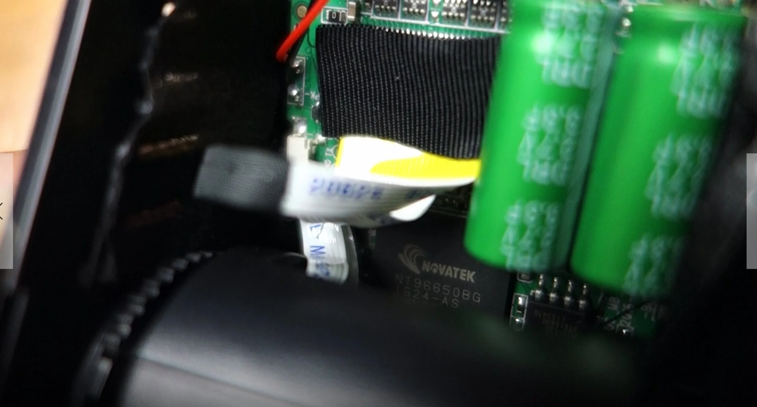

I opened up the camera out of curiosity since the product page did not say its specs. It uses the same Novatek 96650 chipset in the "upgraded" model, which would explain why the 1296p is lower bitrate than the 1080p.
![chipset.jpg chipset.jpg](https://dashcamtalk.com/forum/data/attachments/26/26729-2672db2adaecea41659de6d3ba41ec07.jpg?hash=JnLbKtrs6k)
In the end, if someone is still thinking of buying the A118C it might be worth considering for just a few bucks more than the standard A118C, but it is pretty much the same camera with an extra lower bitrate 1296p mode option. For $20 more you can get an A119 which I would buy myself if I had to choose.
