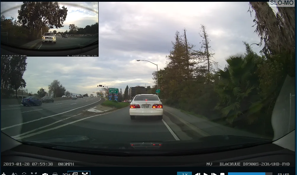

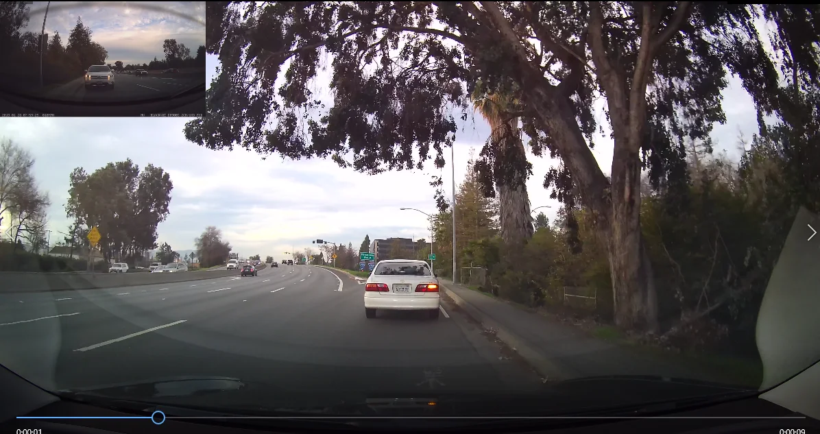

First time user. Trying to merge Front and Rear of one section of video, and then combine that with just front of next 2 sections. I have the 900s, so since you asked about that, here is the Blackvue viewer...
And here is the setting of 3.0
vs. 2.0...
vs. 1.5...
A setting a little higher than 1.5 seems to be closest to the default viewer, but I was happy enough with 1.5
