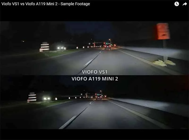

I will keep those points in mind. Here is a more apples to apples horizontal FOV comparison between A119 Mini 2 vs VS1 in what I assume is the 16:9 aspect ratio. The A119 Mini 2 still looks wider when both cams are at the same aspect ratio (I assume). However, I don't know how the videos were cropped, if they were at all.
I do have a question. As the 2 cams approach the same object, the orange road sign on the right side at 3:06 mark, the sign has already disappeared from the A119 Mini 2 while it is still visible on the VS1. Shouldn't the orange sign still be visible on the A119 Mini 2 if it has a wider horizontal FOV? When I am parked, it is the static FOV that counts, right up against my windshield.
I'm trying run this thru my head and if the A119 Mini 2 is actually wider, shouldn't the orange road sign STILL be visible on the A119 Mini 2 video footage?
A119 Mini 2 vs VS1 side by side FOV
Energy efficiency is a priority but I was assuming all 140* FOV cams provided the same horizontal FOV. I know it's not the case but didn't recall the real world FOV between the 2 cams.
Yes!
The problem appears to be that the VS1 video is about 7 frames behind the Mini 2 video during that video clip, although there isn't a way of accurately determining how many frames, which is probably why it is not synchronised accurately. During the previous cut, it is about 3 frames behind, which included a junction where it was possible to measure fairly accurately, but it seems the two bits of video either side of the cut where separately aligned in the video editor timeline.
When you are in a moving vehicle, the effect on the image of moving 1 frame in time, is almost identical to the effect of changing the lens FoV, it can be very difficult to align clips correctly, and almost no reviewers do, some do a lot better than others though.
Yes!
Thanks again NIgel. OK, that explains it.
