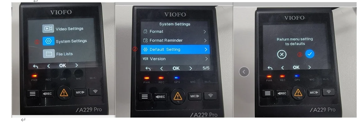

I assume this was about the V1.3, which was released in June?This bug has been optimized in the newer firmware. We will release it soon, please wait for several more days.
