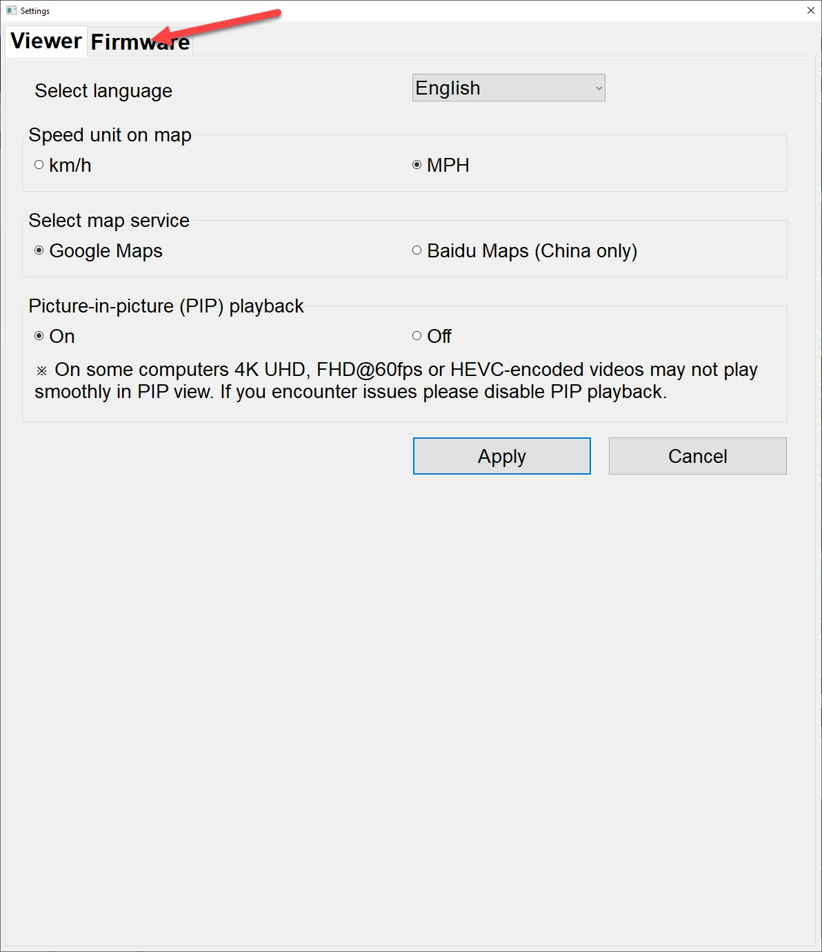

The BlackVue SD Card Viewer program can be used to view all of the video files from all channels in the main viewer. You can examine and edit the firmware settings as well.
1) Mount the dashcam's microSD card on your computer
2) Start the BlackVue Viewer and click on the SD Card Viewer selection
3) Click on the "Settings" button (top middle/right of the screen)
The "G-Sensor" panel in the lower right section of this screen is a read-only view of the three G-Sensor motion values recorded by the dashcam. You see the full one minute's worth of movement values for all three movement indices at the same time.
4) Click on the "Firmware" tab:

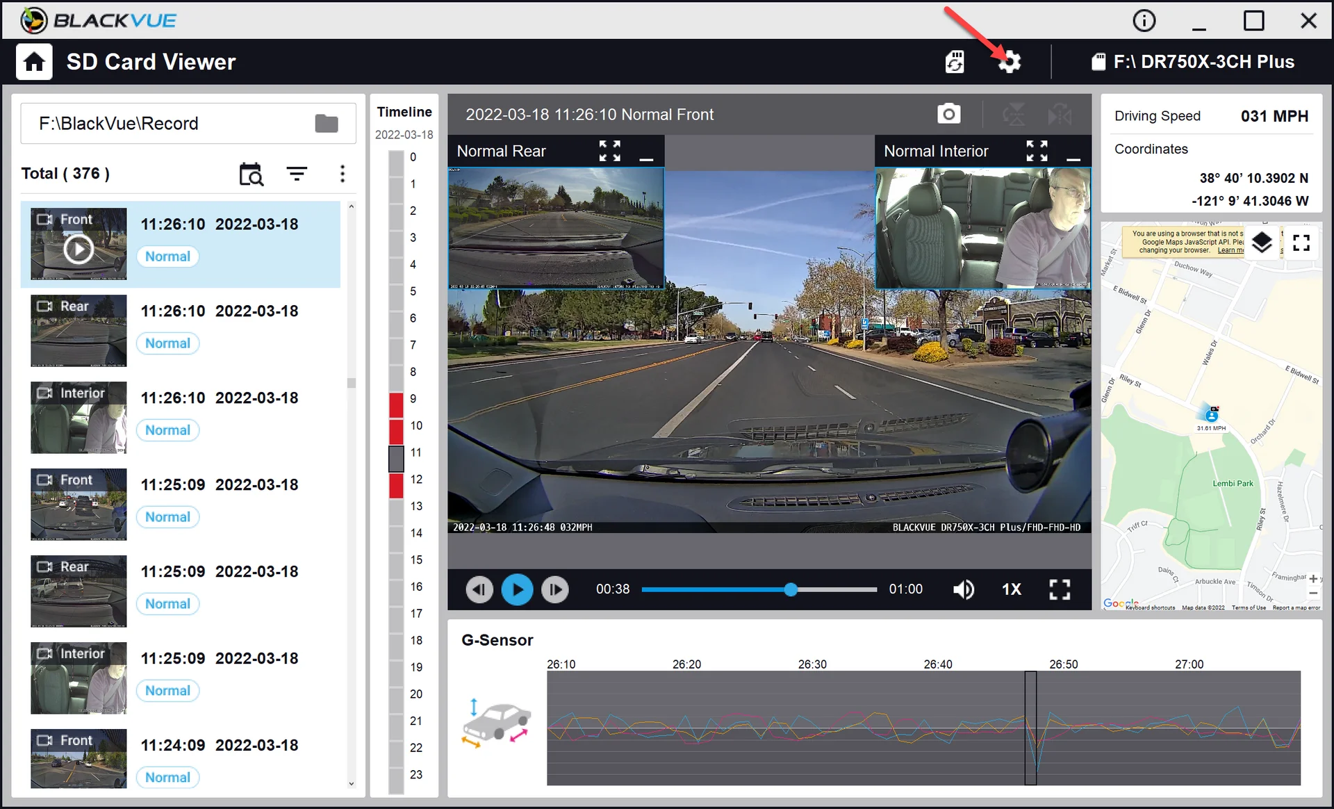

5) Click on the "Sensitivity" tab
6) Click on the "Advanced settings" button for normal mode or parking mode to view or adjust those values.
7) Select a video file from the dashcam's microSD card that you want to playback and see if the dashcam recorded motion values stay within or breach the selected setting.
Off / 0 = No monitoring of this value takes place
1 = Least sensitive value (widest gray band)
10 = Most sensitive value (narrowest gray band)
Any data point on the graph that is within the gray band would be considered an expected/allowed amount of movement for the direction of motion.
Any data point on the graph that is above or below the gray band would be a value that has breached the threshold for that setting and it should generate an event for that motion direction.
To adjust the sensitivity value on this screen, you need to click on the scroll bar on the right side of the display section for each one and scroll up/down to change the value. If you do make a change, don't forget to click on the "Save and close" button to exit this screen.
