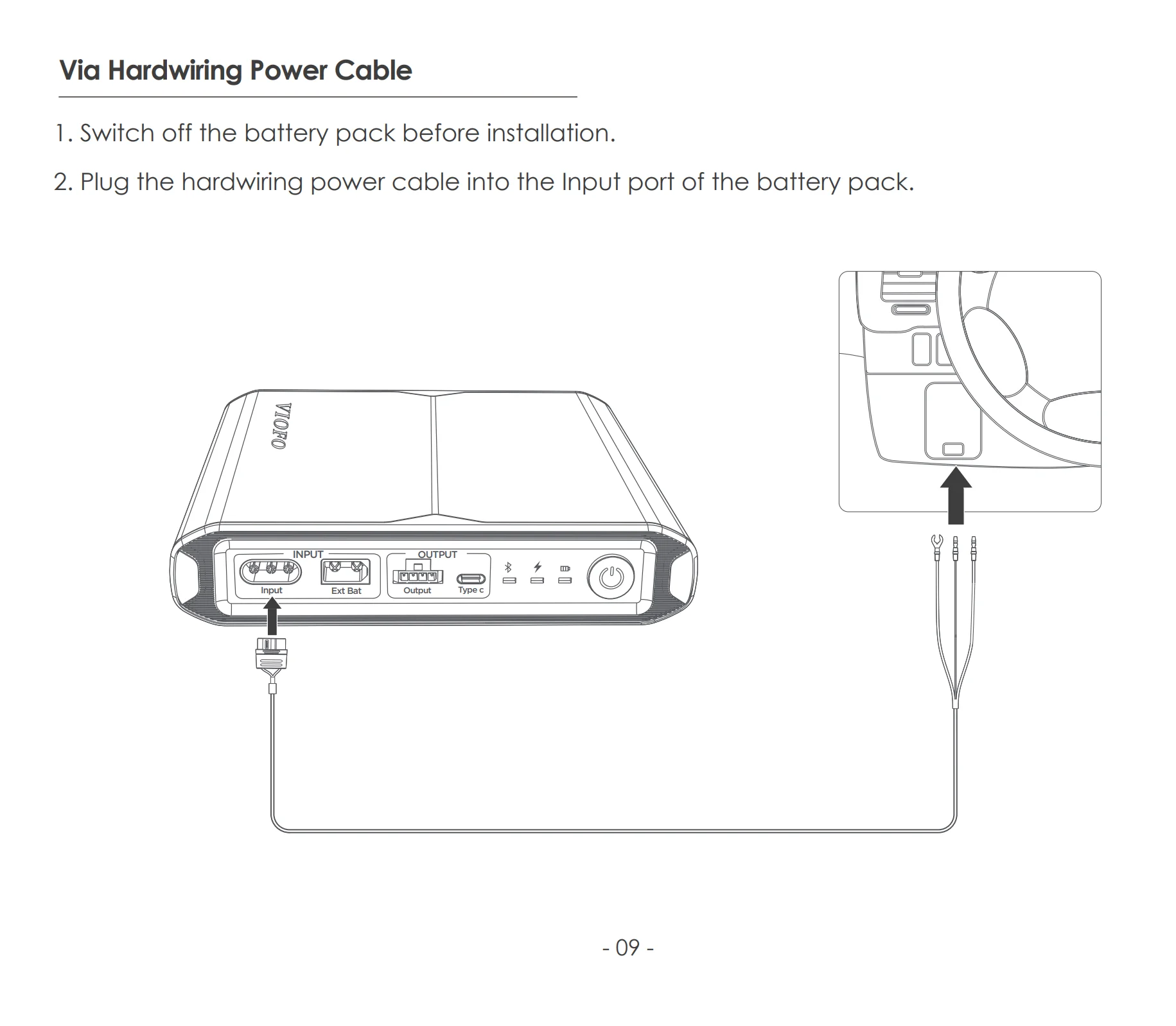

  2. In the manual's installation picture, there are 3 wires going from the BP 100 to the car fuse box, one of them being the Constant power wire. So if I hardwire the BP 100 instead of powering it via CLA, do I just ignore the Constant/red wire and only use the Ground (black) and Switched power (yellow) wires? Or is Constant power still necessary in some instances?

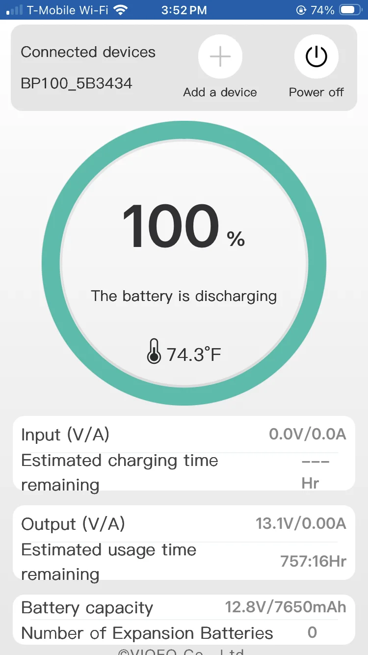

This is the BP100 when the car is not running and ignition is OFF
In this case my BP100 is connected to the CLA (not hardwired).
There is zero input voltage and current. The same should occur when it's hardwired into a vehicle's fuse box.

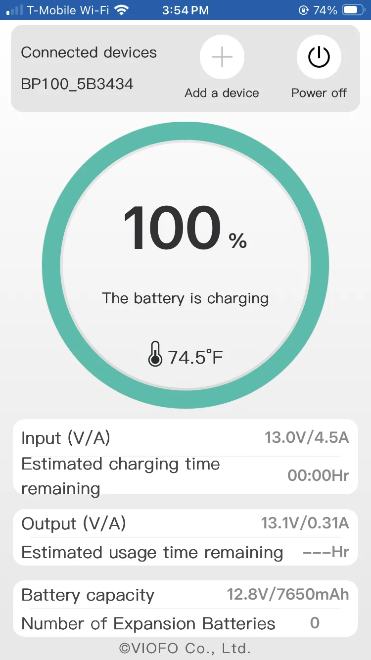

This is the BP100 with the ignition ON but car not running.
Its drawing 4.6A at 10.8V.
This is the BP100 with the car running.
Its drawing 4.5A at 13V
2. You asked "In the manual's installation picture, there are 3 wires going from the BP 100 to the car fuse box, one of them being the Constant power wire. So if I hardwire the BP 100 instead of powering it via CLA, do I just ignore the Constant/red wire and only use the Ground (black) and Switched power (yellow) wires? Or is Constant power still necessary in some instances?"
Constant power is absolutely necessary. That's where the charging current comes from. Switch current is a low current signal to command the battery to accept current from the constant current wire. There are some external batteries that have only two wires for hardwiring (switched power and ground) such as my PowerCell 8. This is an inferior method of obtaining current from the car's electrical system since most car's ACC fuses can't handle the extra heavy current demand (10A) of an external battery. By having a third wire (constant power) is allows you to connect to a more robust terminal (the best would be right at the car's battery terminal).

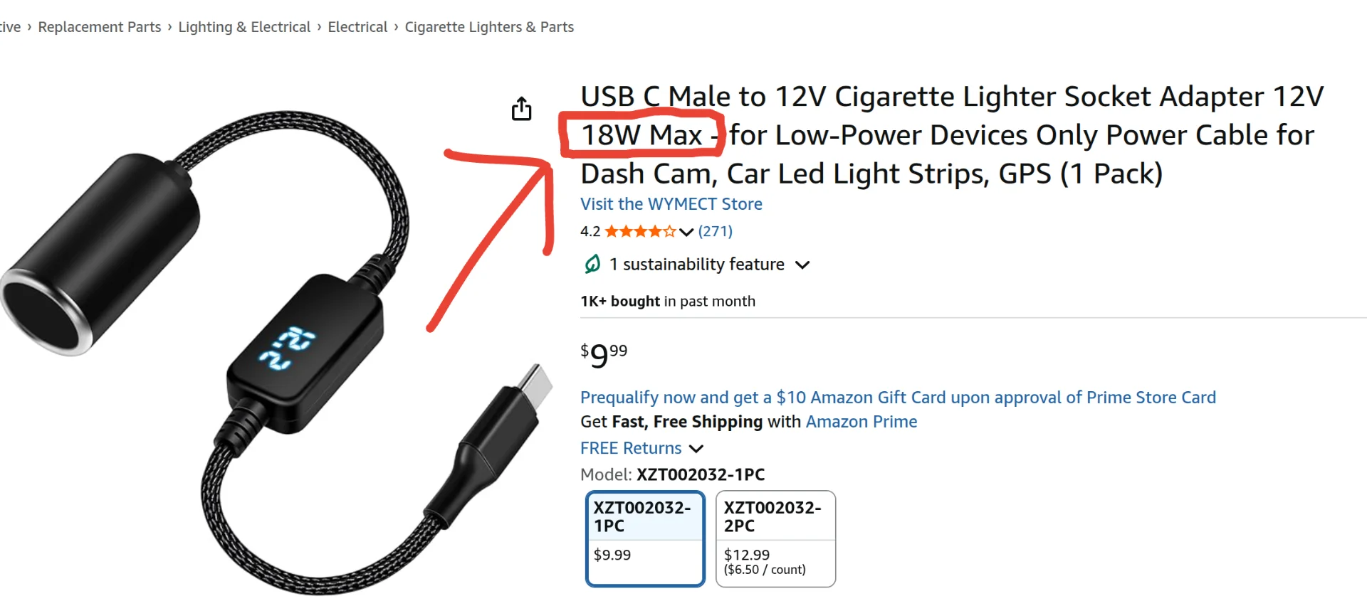

  1. Can the BP 100 be powered using a USB A or USB C port located in the front of the car using an adapter like this one (https://www.amazon.com/gp/B0F87WNQKB) or would the provided power from the USB port/adapter combination be too weak for the BP 100?
  2. Assuming USB power is insufficient, does anyone have any other suggestions for using the 12V port within the center console without worrying about the wiring getting caught and clamped on? I open and close my center console fairly often

Thanks @Chuck McCoy I figured as such. Would you happen to have any suggestions how I can go about solving the center console wiring issue without making modifications like drilling extra holes? Or would you suggest hardwiring the BP 100?

The BP100 comes with a Hardwiring Power Input Cable. Are you comfortable connecting that to your interior fuse box without drilling holes? This seems easily reversible, so you can hide it from the dealership and any warranty issues. [Caveat - I just installed my BP100 using its cigarette lighter input. I don't touch the fuse box if I can avoid it.]
