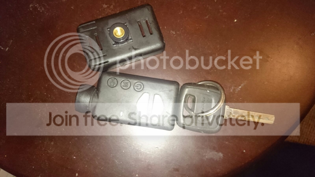

I think its a C2 bought it a few years ago now, anyway the LED on the bottom flashes blue when its recording in the car but theres nothing saved on the SD card when I plug the camera into my phone, which is a shame as I was in a collision recently!

The suction cup has fallen from the windscreen a few times over the years, this may have caused the problem, I'll have to buy the right sized screwdriver before I can take it apart. How long can these thing last without any charge as it has been a couple of weeks already.
