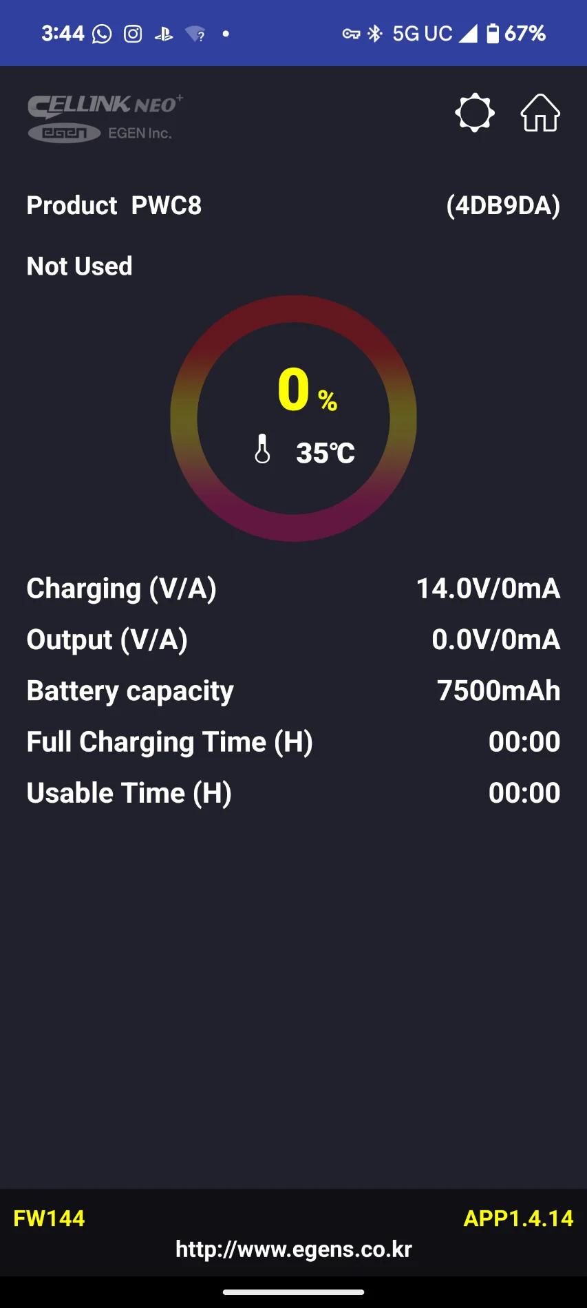

Thank you. I brought it back yesterday they added the Hk4 hardwiring kit to the powercell 8 I told them about the yellow and red wire. still haven't entered parking Mode overnight. After work today the Dash cam was off and would not turn on. Brought it to another tech they said I need a new powercell pack. its not getting power to power to the dash. Think I need to update the dashcam attached pic of current firmware and Battery pack
Looks like your battery isn’t getting power and charging. Hopefully they wired that in correctly? It comes with the proper cabling and documentation your installers can reference.
Assuming they hardwired it properly (based on wire function, not color), and then you enable parking mode on the dashcam, it should all work from there.
