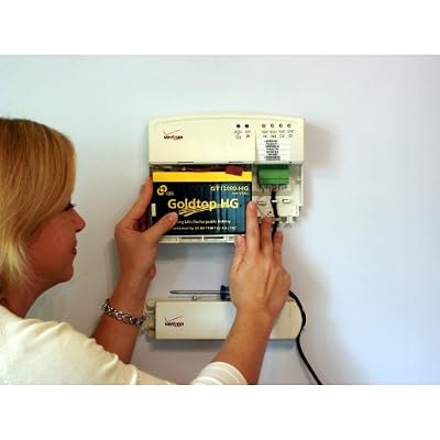

I found out this exact same 12V 7.2Ah battery is also used by Verizon FiOS as back-power. Only $26 on Amazon.
https://www.amazon.com/gp/B007ZHAYL6
picture below show the size of the battery... the yellow one that the woman is pushing into the Verizon FiOS device.
