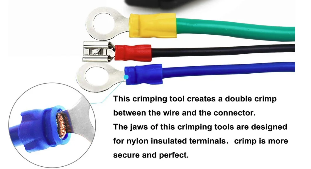

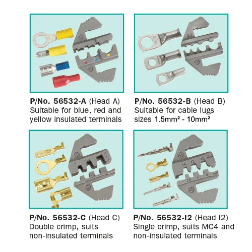

I have a crimping tool that I bought some years ago which came with a selection of connectors. (this one: https://www.amazon.co.uk/gp/B07JFK58R3)

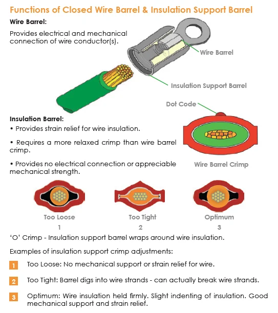

I found the cablecraft document on crimping which has a section on insulated connectors. It suggests that insulated connectors typically have insulation support barrel:
However that all the insulated connectors I have seem to just have the wire barrel and no additional insulation barrel.
Looking at the tool it has a kind of ledge bit meaning it does the actual crimp and also does a more relaxed crimp on the nylon insulation at the same time. You can see this, the 'wing' part is the more relaxed crimp on the insulation.

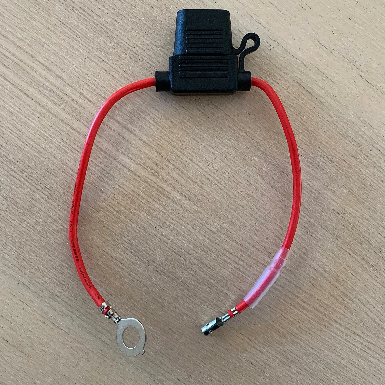

I looked at some my fuse taps to see what type of crimps were used:
The one on the right was done by a similar tool (maybe even me), the others done by a one crimp tool (either a ratching tool or the more basic type)

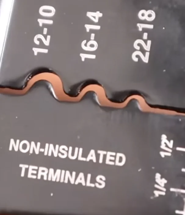

But it looks like they maybe used the a non-insulated tool like this:

- If I wanted to use insulated heat shrink type of terminals, the tool I have would be useless as it's going to crush the heatshrink bit.
