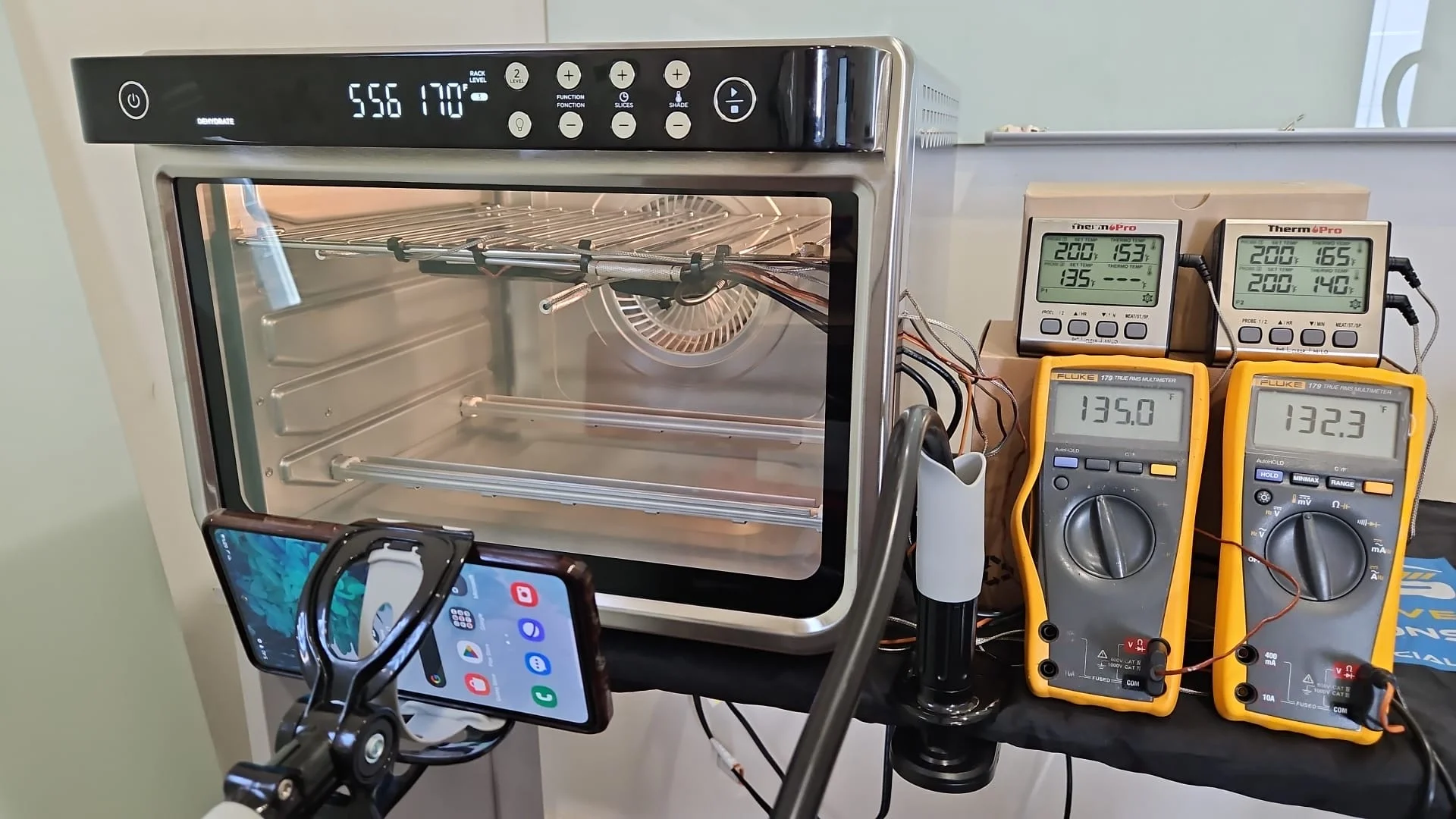

We have begun doing heat tests on the following dash cameras. @Ted@SafeDriveSolutions has been conducting the controlled tests
Viofo A229 Pro
Vueroid D21 4K
Blackvue DR970X Plue Lte
Fine Vu GX4K
Vantrue N4 Pro
70Mai A810
There is some interesting results we have seen so far. STAY TUNED as more info will be added to the post and video will be released hopefully very soon
We are trying to get it out for this weekend. Lots of editing. All the videos are at least 4 hours in length of the test and we need to dial it all in and try and give you a nice short video.
Here is a sneak peek video. There is so much video that we are going to have roll it out slowly.

Oooh its getting interesting
Only 1 unit lasted over 200 degrees fahrenheit. But still we thought it was kind of irrelevant, but maybe not

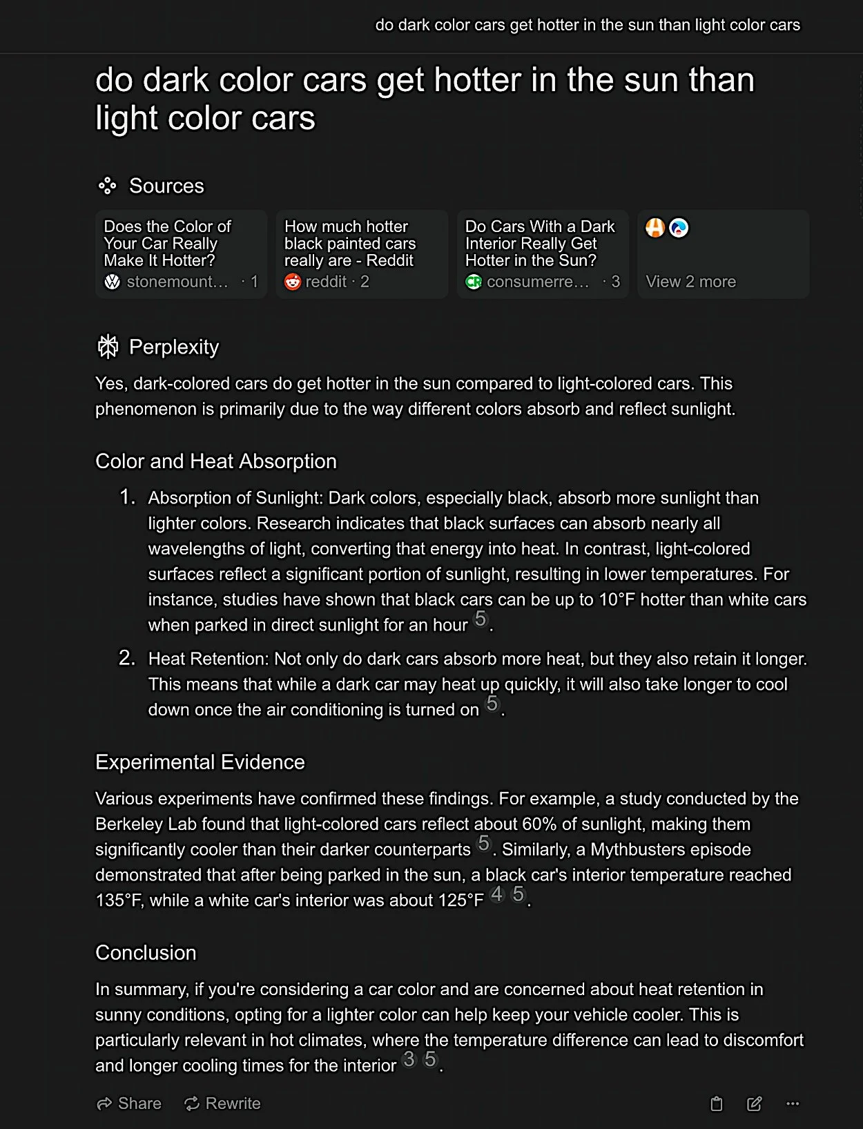

Here is what Perplexity AI has to say on the matter. (built on GPT-3.5 but is openly connected to the internet for up-to-date information)
Link: https://www.perplexity.ai/search/do-dark-color-cars-get-hotter-DIcMiSJhSimZT.DgwyAmJQ
  • Black cars tend to absorb more heat than white cars because the color black absorbs more sunlight than white.
  • On average, the cabin temperature of a car that’s been left outside for an hour can reach 43 degrees higher than the outside temperature.
  • To keep your vehicle cool during hot days, consider parking in the shade, tinting your windows, and using a sunshade or reflector.
