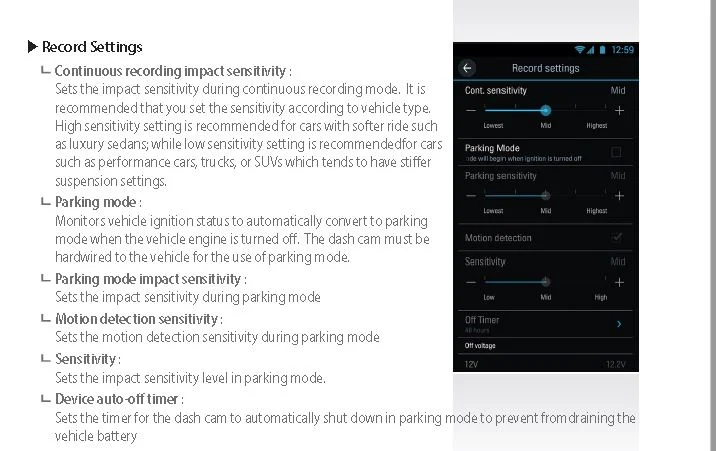

and the manual is not so clear abt it... (see attached)

When you run the camera in Time Lapse, motion recording no longer works it's just Shock & Time lapse.
Otherwise you can put it to Motion recording instead of time lapse but then turn the Motion sensitivity (Record Settings - Motion Detection - OFF) to the lowest level which is OFF! So it will just record shocks....HTH
