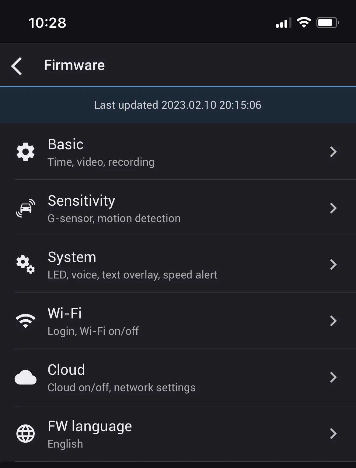

From the App - MyCameras
1. Click the 3 dots to the right similar to “:” but has three dots.
2. Click on Settings
3. Click on Firmware
4. Click on Basic
5. Click on Recordings
6. Click on Parking Mode Recordings
7. Click on Motion & Impact
8. Click on < to back out to Basic
9. Click on < to back out to Firmware
10. Click on Sensitivity

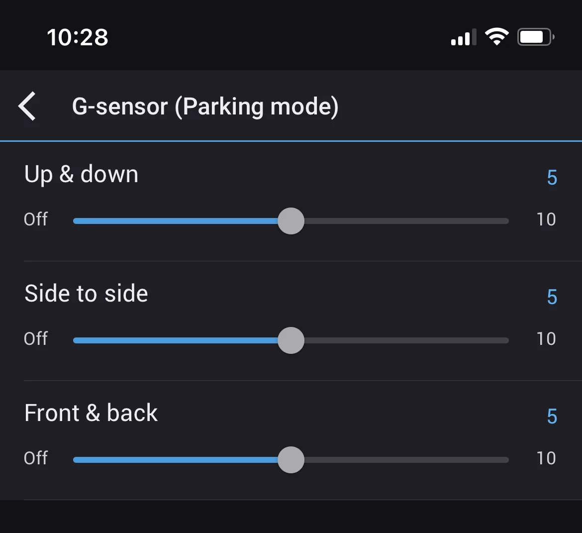

11. Click on Motion Sensor Parking Mode - Make any adjustments required such as to the area monitored. For both Front and rear cameras. My preference is to use the bottom two rows only; But test for yourself to see if good for your needs. You can also use slider to adjust sensitivity from off to 5.
12. Click on < to back out to Sensitivity
13. Click on < to back out of G Sensor Parking Mode, make adjustments for up/down, side to side, Front & Back
14. Click on < as needed to back out.
15. Test and repeat as needed for your situation.
