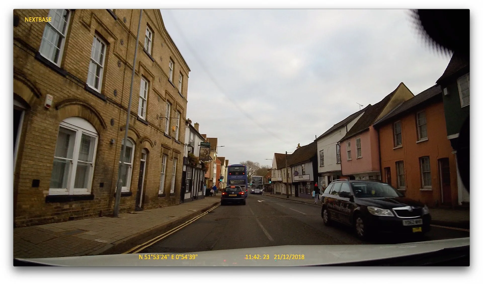

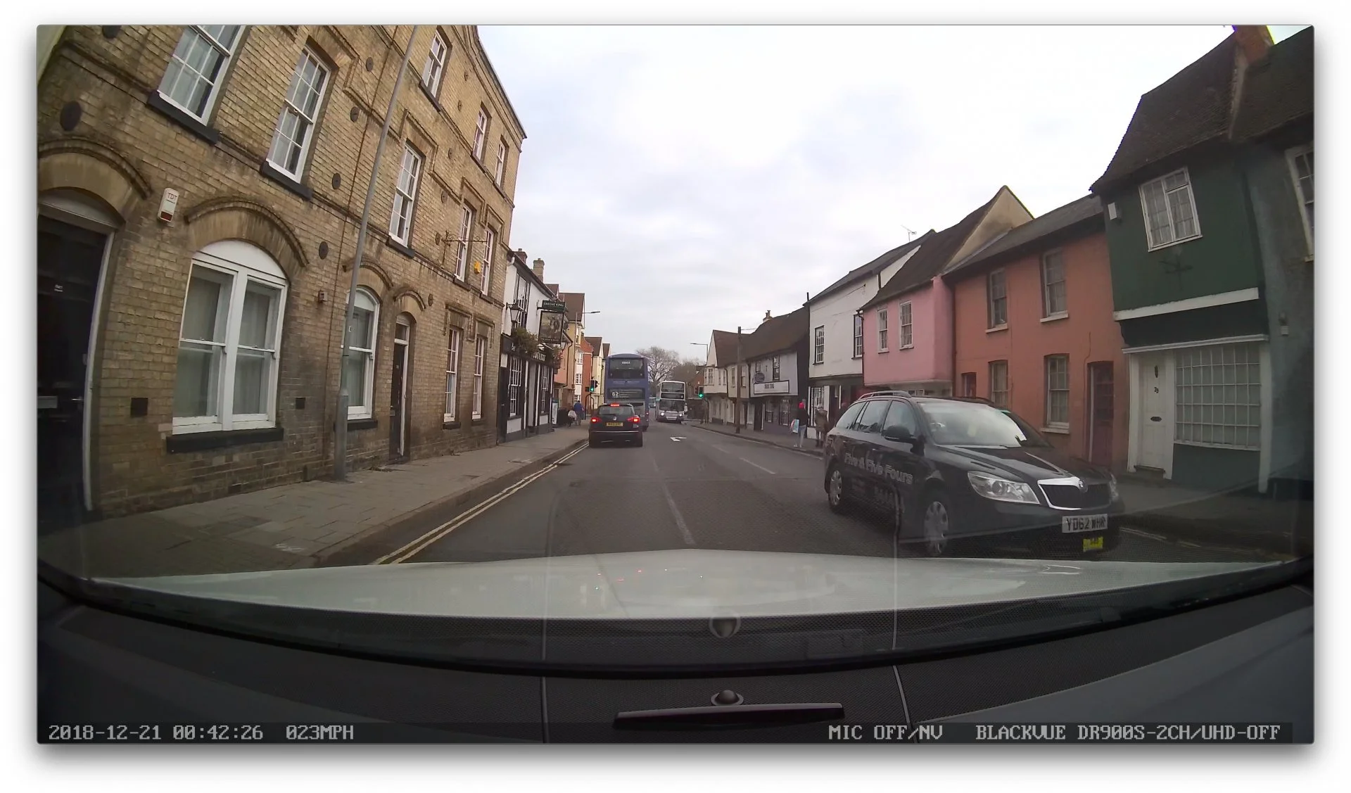

Thanks to Halfords for letting me borrow a 612GW for an hour....Had both the BlackVue and NextBase set-up in the car next to each other....These are the results.
First NextBase
Now the BlackVue (And what I would expect the quality of the NextBase to be like!)
No GPS position on the Blackvue ?
What is the aperture? The 612 is f/1.6
Not embedded on the display, no - but not essential as dragging the videos into the software they provide gives the location - one thing that NextBase did do better...Plus the NextBase software is a little more user friendly and has the red marker to show you the route in each video.
Although I like being able to change the settings from the software with the BlackVue - each camera has it's plus points and weaknesses, but essential here is the quality of the recordings.
Not sure, but I'll see if I can find out - couldn't see anything printed on the unit.
I like to play my footage in VLC or Firefox, full screen, and for my needs I require the GPS position viewable.
Thanks for posting the images as I can now take Blackvue off my next dashcam list.
