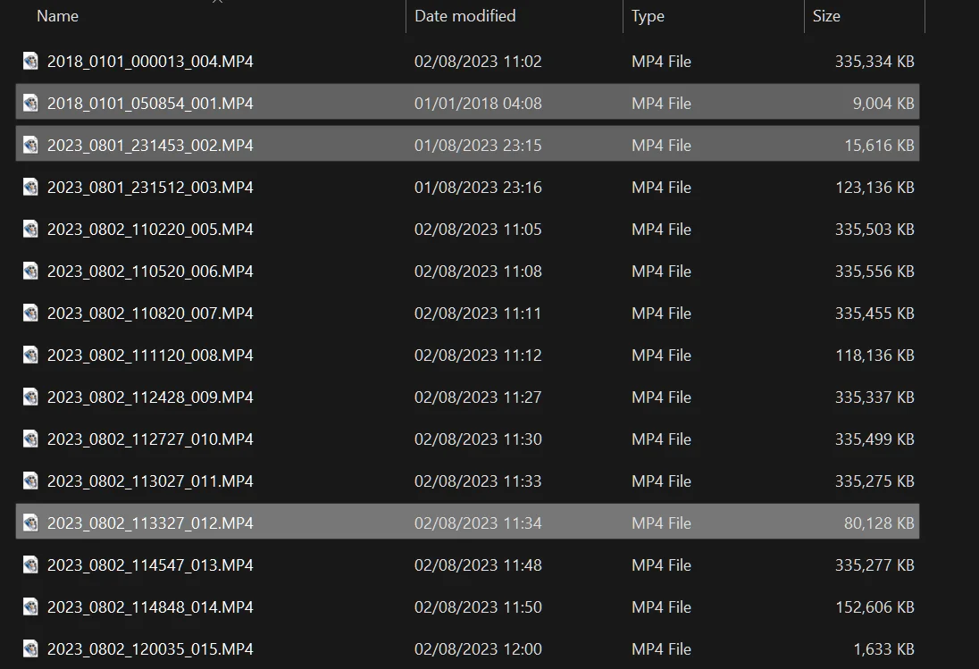

Can you confirm that these files are in order?don't know how to tell if the RTC is fully recharged, I left the dashcam connected for 3 days give or take.
Change the RTС battery, it's not difficult and inexpensive, then we'll see.The ones you circled are in order. They're the last two videos of the drive.
