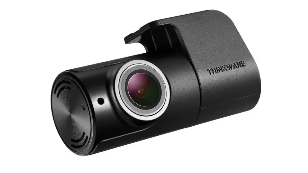

Thanks for the replies guys. What would you guys recommend I modify this with to have temporary suction, basically be able to remove it with ease instead of the 3M tape that comes with this. A suction cup hookup sounds amazing, just not sure how I'd attach it and make it work with the rear camera (shown below)
Some people use a "radar detector' mount for this- they have a large flat surface you can attach to. Usual sources like Ebay, Amazon, AliExpress and such. Many types, one should work good for you.
