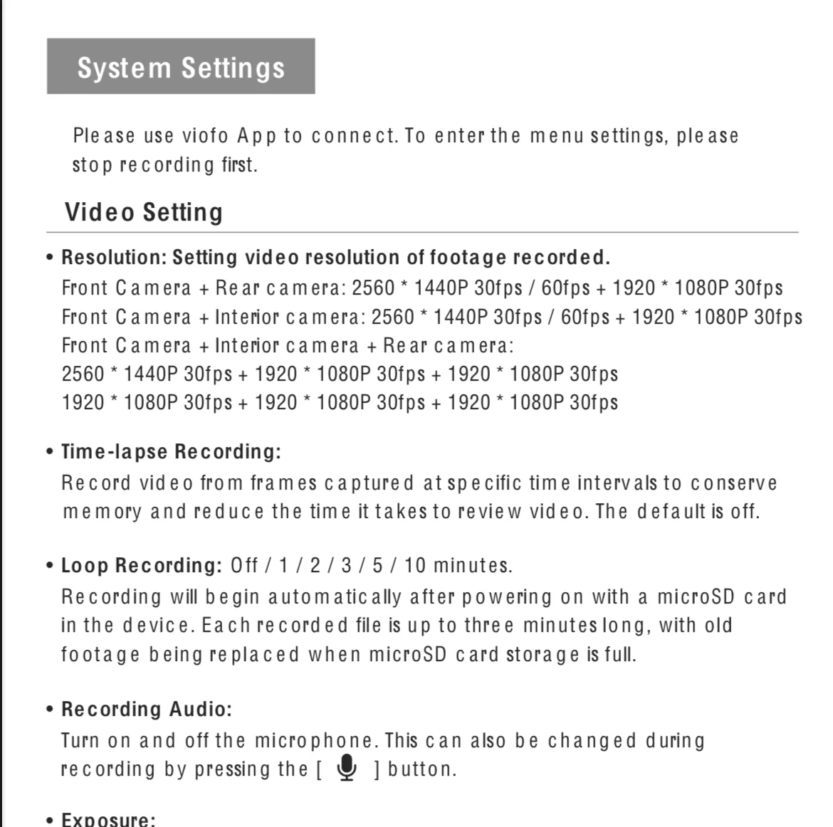

The user manual says that there is a 1440p 60 fps option for single-channel or dual-channel use, but on the resolution selection screen there is only one option, 1440p 30 fps.
Could the manufacturer have been too lazy to prepare a new manual and copied the manual for the a139 pro model verbatim?
I could not see a 60 fps option for single-channel or dual-channel use.
@VIOFO-Support
I've only seen 1440p60 available in single channel mode. It defaults to that if I unplug the rear camera. That is with HDR off.
There is only one option by default for me. That is always 1440p 30fps. Single channel, dual channel, triple channel, it doesn't matter. Is it possible that there are hardware differences depending on the production year?
Ok. I couldn't see the 60 fps option even though I checked it during the day in HDR AUTO mode. However, the 60 fps option is visible in HDR OFF mode, so the technical data is correct.
I'm just a little confused. Can't it automatically switch to 60 fps during the day and 30 fps at night when HDR AUTO is on? As far as I remember, this switch was made automatically in the A119 mini 2.
Am I wrong?
You are correct for the recent cameras, I'm not sure that the A139 does though.
Try it with the latest firmware and find out, if it doesn't work then ask Viofo to implement it in the next A139 firmware.
