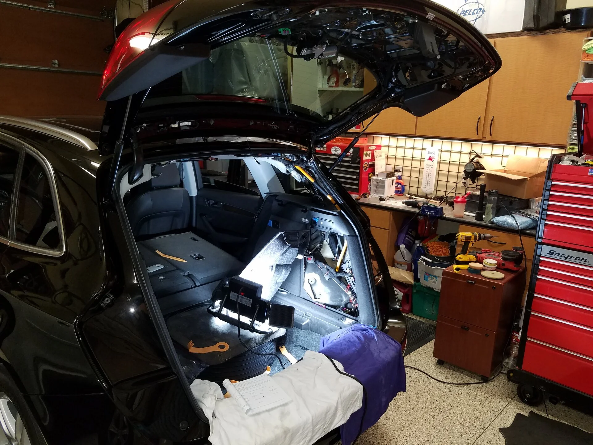

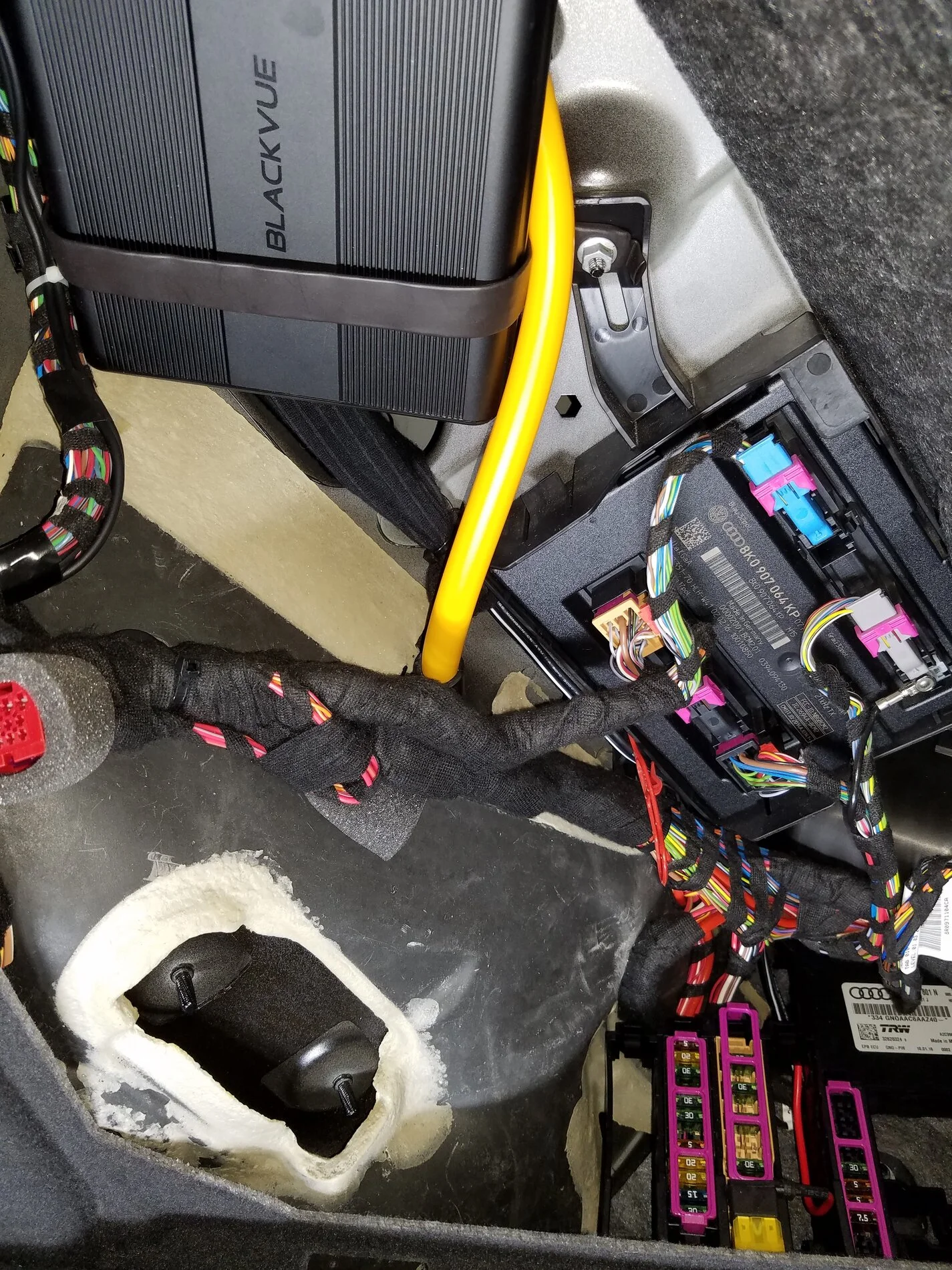

Ideas for a Secure and Clean looking Battery Pack Install in an Audi. with a DR900X-2CH

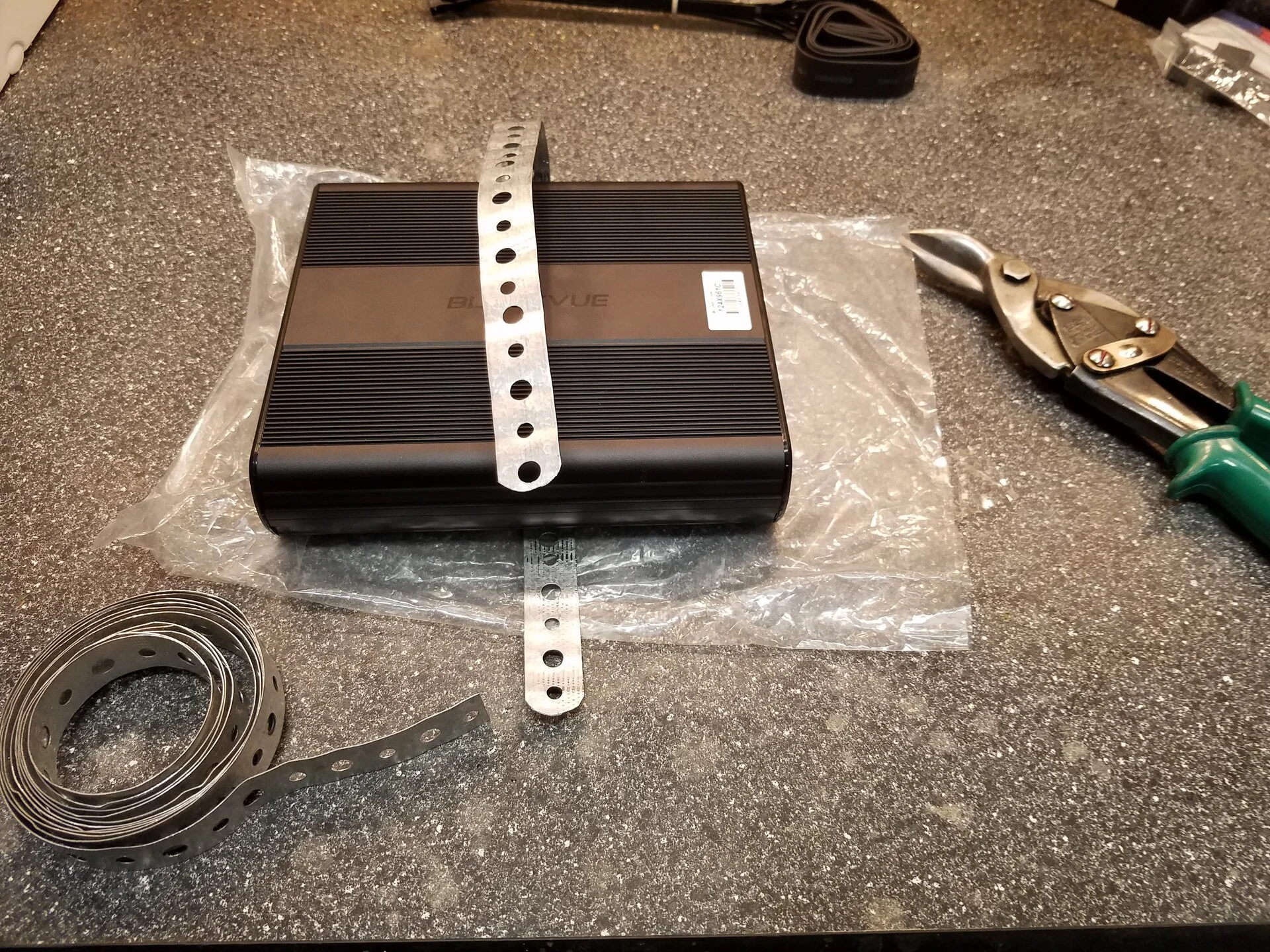

I Used Heat Shrink wrap (Double Layered) around steel Plumbers Tape To secure it safely out of the way.
Fortunately there was plenty of room in the back of the car and right above a set of fuses.
Super clean and easy to install and get to settings if I ever need to.
Now I'm considering adding a DR750X-2CH, where I'll put the rear cameras on the sides and the DR750X main in the rear window.
I can simply stack another Battery on top and plug into the expansion port on my current one.
