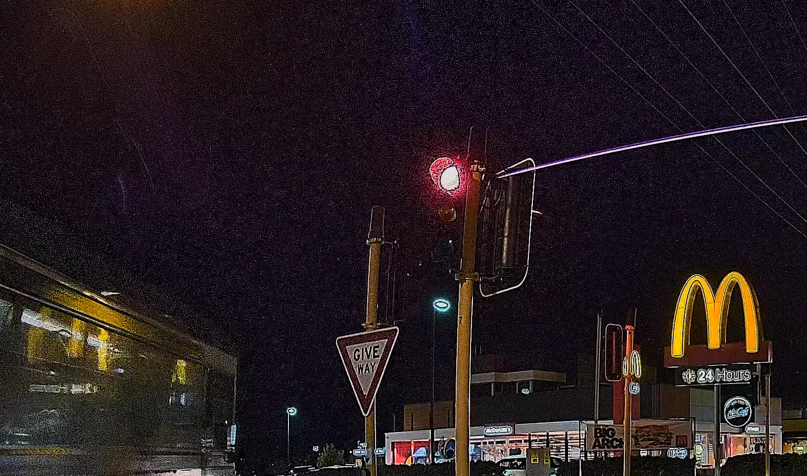

But that sign is the Burger King sign! Or maybe the McDonalds sign?
Why are counterfeits the chinese dascams? Viofo is a dashcam leader and it is a Chinese manufacturer. Is Viofo a counterfeiter?
good
@Xuqi99 thanks for sharing the footage. Your footage like absolutely grainy on my 4K 32" monitor (please open the full image to view the grain). This is unacceptable on a dashcam in this price range, where Chinese counterfeits are getting better quality with third of the price.

Ghosting effect (on older firmware the street lighting overhead would leave a ghost trail whilst in motion) is now reduced but overall quality seems very grainy now, to the point you can't make out any number plates of close vehicles whilst in motion..
