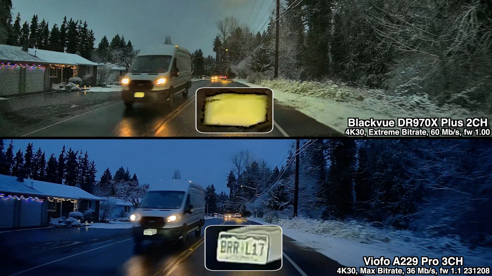

I'm looking through some sample footage now and I'm very unimpressed with what I'm seeing from this DR970X Plus. The footage is grainy and even if I compare it to the A229 Pro running as a 3CH setup, the Viofo still looks better and does a better job of grabbing plates, despite its lower bitrate.
Edit: Whoops! Sorry I posted this in your thread @rcg530. I’ll create my own thread later to share my impressions and sample clips.
I wish the image temperature could be somewhere in the middle of those two, the viofo are cold and the Blackvue warm
That is a crazy difference.
It looks like a blur tool was used it's that bad.
