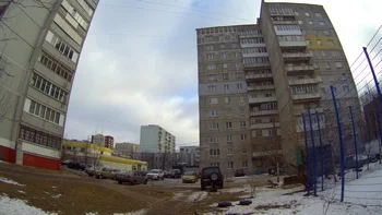

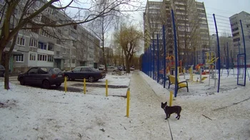

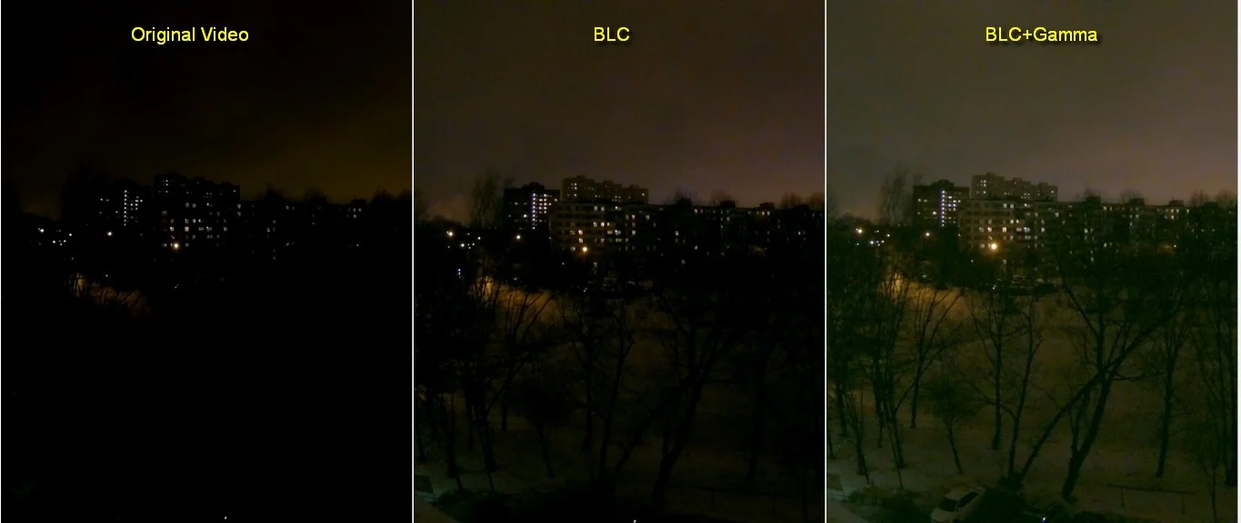

EKEN H8 PRO Finally real 4K
Can you share settings? Does this work in video mode?
At this point in time the firmware was tested Russian users.

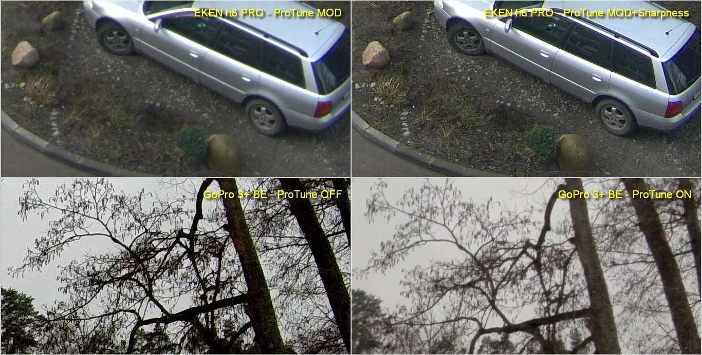

It will be two versions of the firmware: standard and protune.
The second firmware is better suited for postprocessing because
digital filters are disabled intracameral video processing.
The original test video can be downloaded in the description to the movies...

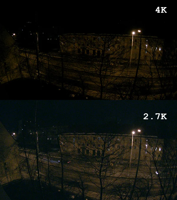

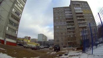

thanks.. any reason you didnt choose 4k for this one?
In the dark, it's better to shoot in 2.7K.
In bright lighting, the picture is better in 4K.
In the dark time between 1080p and 1440p there is no difference...

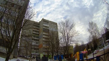

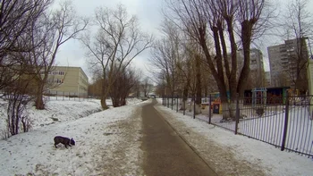

You can set the ISO range:
These parameters work for video mode.
The maximum ISO value in the original firmware is 800 units.
I limited the value to 100, 400 and 3200 units as an experiment.
In passing, I want to cancel the duplication of frames with reduced lighting.
You can also lock the AUTOKNEE and EXPO parameters.
Now I'm just experimenting in this direction ...

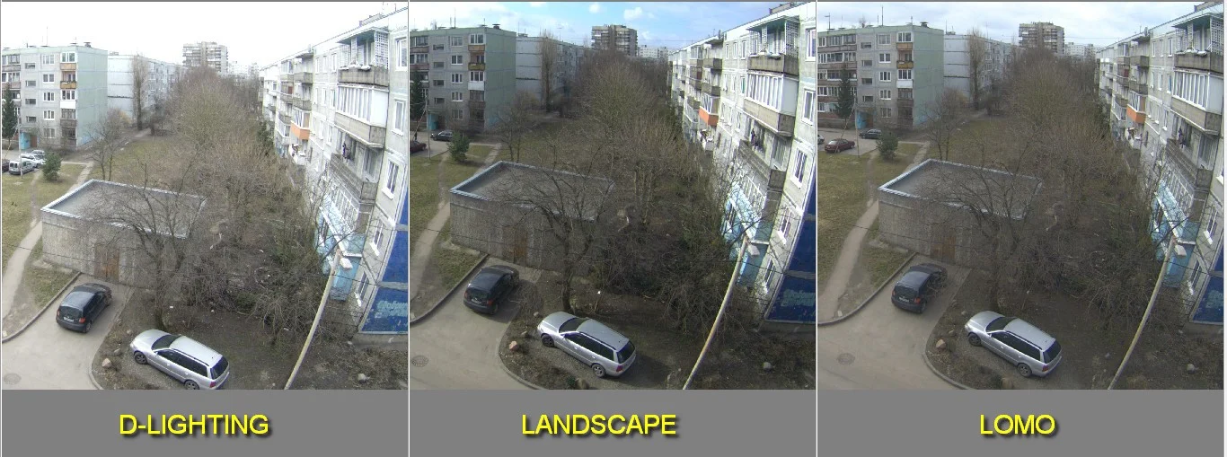

Scenes...
Code:
 SCENE_OFF
 SCENE_FLASH
 SCENE_TV_OFF
 SCENE_AV_OFF
 SCENE_SV_OFF
 SCENE_TV_ONLY
 SCENE_AV_ONLY
 SCENE_SV_ONLY
 SCENE_NIGHT
 SCENE_NIGHT_PORTRAIT
 SCENE_SPORTS
 SCENE_LANDSCAPE
 SCENE_PORTRAIT
 SCENE_SUNSET
 SCENE_SAND_SNOW
 SCENE_FLOWER
 SCENE_FIRE_WORK
 SCENE_WATER
 SCENE_BACK_LIGHT
 SCENE_BACK_LIGHT_PORTRAIT
 SCENE_TRIPOD
 SCENE_BLUE_SKY
 SCENE_MACRO
 SCENE_MACRO_TEXT
 SCENE_ARENA
 SCENE_D_LIGHTING
 SCENE_MUSEUM
 SCENE_BEACH
 SCENE_CHILDREN
 SCENE_PARTY
 SCENE_FISHEYE
 SCENE_INDOOR
 SCENE_THROUGH_GLASS
 SCENE_PANNING
 SCENE_PHOTO_FRAME
 SCENE_LOMO
 SCENE_SELF_PORTRAIT
 SCENE_CAR_DV
 SCENE_CAR_DV1
 SCENE_AUTO
