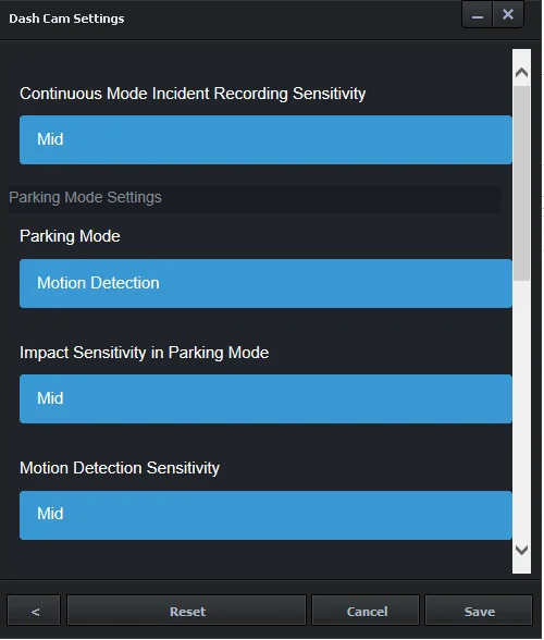

Can anyone look at the attached. This is what my dashcam settings are set at, I have fiddled with the settings but cant het the one I want.
It is recording motion, for example people walking past etc, I don't want this, all I want to do is to have the dashcam in the mode which will record any incidents if some bumps into my car when its parked.
Can anyone tell me what to change in the setting to just have the mode I have stated above. I'm not interested in recording people walking past my car.

The three dots seen in the lowest box to the far right of the camera icon might be a drop-down menu or lead to a settings menu. I'd click there and see what happens ;)
Dash Cam Settings - Recording Settings - Parking Mode (y)
Motion will record 10 seconds before & after any movement detected (You won't get that many recordings on the standard size 16gb card though especially as you have Front & Rear) also if it detects an impact it will also record 10 before & after.
Energy Saving stops recording to save power but if it detects an impact it will wake and start recording within 1 second. You would miss the actual event but get the aftermath. As it uses less power the camera will last longer before shutting down due to low battery voltage.
I recommend setting the Impact Sensitivity in Parking Mode quite high so smallish impacts are detected. Also i usually recommend 12.0v for battery shut down level.
Excellent, I'll do these settings and see how it goes.
I have a Thinkware 64gb card fitted, so that should be ok.
Thanks
With a 64gb card that should be 190 (about 63 minutes in total) Movement detection's it can save on the Default 'Continuous' Priority setting.
