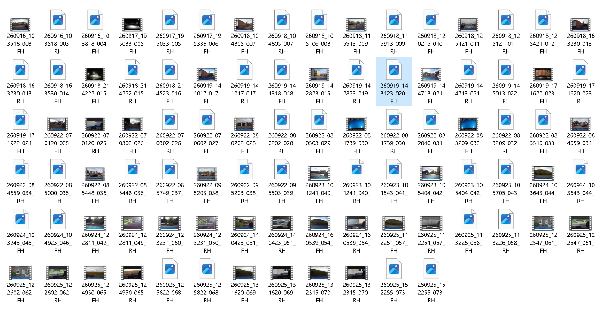

thank you LateralNW, card purchased from Argos so should be legit and has worked since 1st purchased, cam hardwired by Halfords picture shows stil from video, so it can record,, also list of files taken from SD card , videos shown but others are the faulty clips hence the original warning, faulty files end with RH, good files end with FH, convinced it must be the SD card so going out to Halfords to buy nextbase sd card and hope that works, still no idea on why no display oncameraaftera few seconds of coming on
