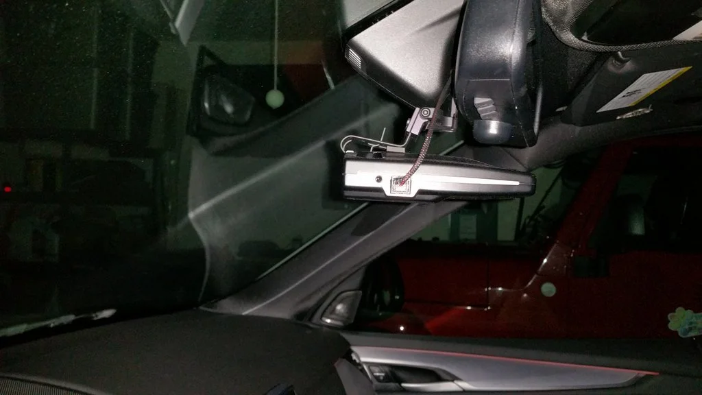

I have been beating my head for weeks now trying to pick out the best dual cam solution. I am in Indianapolis Indiana and have a 2015 BMW X5 xDriver 35i MSPORT SUV. (The OEM camera system is pretty extensive with front, rear, and top camera views.. but none none are available while you are at speed.. only when you are parking or at full stop). Had it down to blackvue 650 and Lukas 7950. The form factor on the 7950 was a little large and the 650 came out in 2014 and I would think the technology is just older and it had 720 in the rear instead of 1080.

5) Do I have enough room to mount this under between my radar detector and below the panel behind the rear view mirror without interference?
