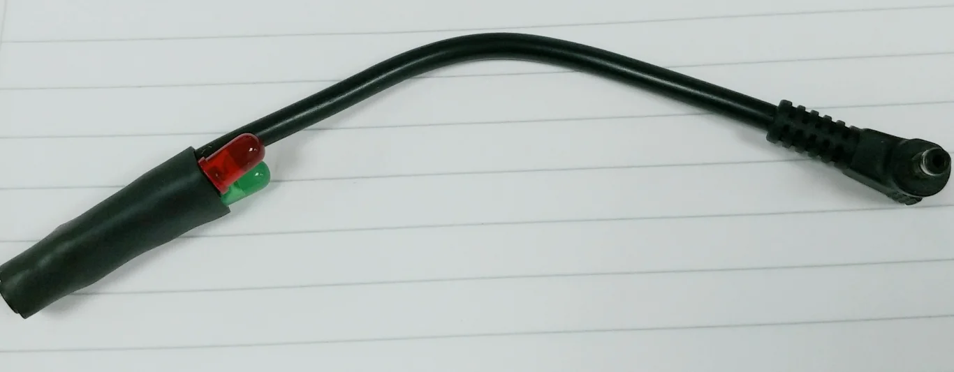

@blackrat if you message me your address i have a short cable i made up a while back and i will send one to you that will plug inline with the camera but just has a couple of LEDs attached to it to show if the Permanent Power (Red LED) and the Ignition Power (Green LED) are present. Whilst driving both should be on, when Parked only the RED Led should be on. The only thing to keep in mind is the LEDs start to illuminate dimly at about 4 volts so need to make sure they are full brightness.

@blackrat if you message me your address i have a short cable i made up a while back and i will send one to you that will plug inline with the camera but just has a couple of LEDs attached to it to show if the Permanent Power (Red LED) and the Ignition Power (Green LED) are present. Whilst driving both should be on, when Parked only the RED Led should be on. The only thing to keep in mind is the LEDs start to illuminate dimly at about 4 volts so need to make sure they are full brightness.View attachment 49479
