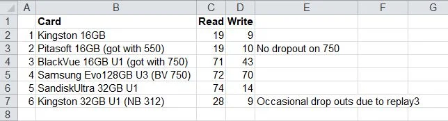

As we seem to have drifted off fakeness and into speediness, I thought that I would put my 5 eggs into the basket. I have a few micro SD Cards as shown below
My BlackVue 750 2CH records 1 min clips with the front cam 1080@60fps and the rear cam 1080@30fps simultaneously.
The file sizes according to W10 file explorer are 98,500KB (front cam) and 83,940Kb (rear cam). This is a total of 182,340KB
The card that came with the cam is the BlackVue 16GB (#3) with a write speed of 43MB/s, and the one that I actually use is the Samsung Evo 128GB with a write speed of 70MB/s.
So, I said to myself, let's try a slower card and see what happens. I stuck in the Pitasoft 16GB (#2) card with a write speed of 10MB/s and guess what? It worked just fine and dandy with all recordings there and no drop out.
Now 182MB (approx) at 1 min record time would be a transfer rate of 3.05MB/s (about 25Mb/s), which of course is well lower then the 10MB/s of the card. So, no real surprises there then.
As this seems to be the case, why do cam manufacturers @Tiffany claim that you need a card with 50MB/s write speed?
@Tiffany. Whilst I was doing that, I also investigated my wife's NB 312 files the were recorded on the Kingston 32GB (#6) with a write speed of 9MB/s. When played back through Replay 3, they has momentary pauses in the playback as if data transfer was a problem (card reads at 28MB/s). However when played back through a couple of other viewers, there were no glitches at all. What's going on with RP3? Whilst I am on the subject of RP3, why does in not automagically list the files on the card when you stick it in the PC like the BlackVue viewer does? It's a pain in the butt having to go looking for the files.
