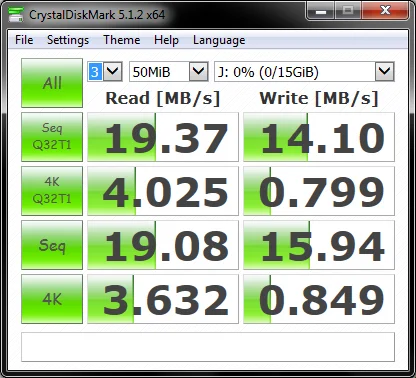

EDIT: These are the benchmarks I got. First is the stock 16 GB card that came with the CF-100 in my laptop's built-in card reader.

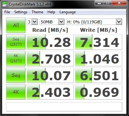

Next is my current PNY 128GB using my laptops built-in card reader...

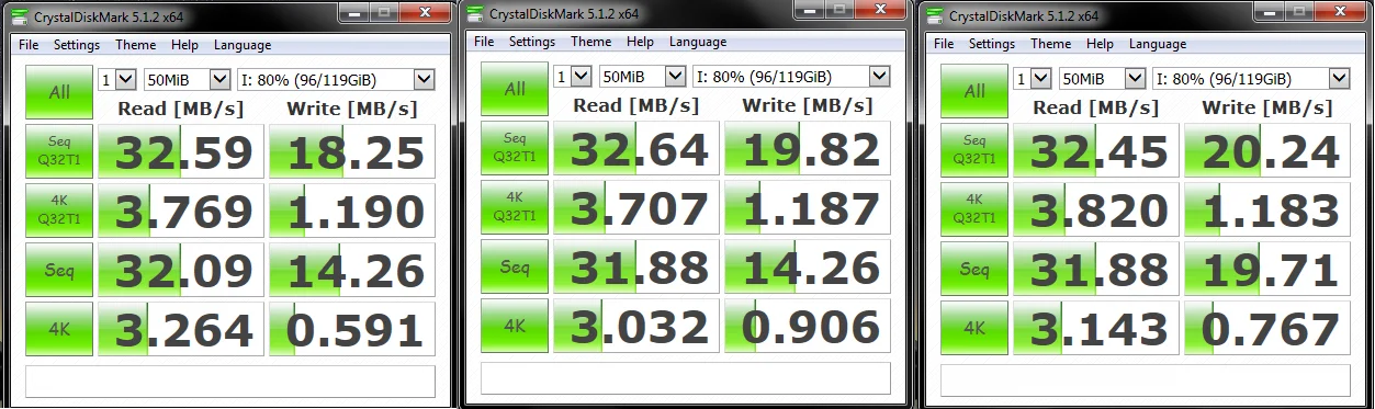

Lastly, same PNY 128GB card using an Anker USB 3.0 card reader, plugged into USB 2.0 port. It's read speed on this one is limited by what USB 2.0 is capable of. Write speed is more or less as advertised.
