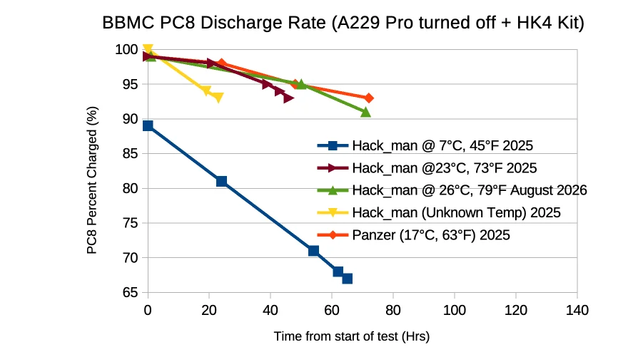

I own both.
The PC8 self discharges 8% per day with no load. Perhaps I got a dud. The BP100 loss is less than 1% per day.
The BP100 processes warranty claims via a US address vs Canadian for the PC8.
The BP100 has a much better bluetooth range and also can receive OTA firmware updates.

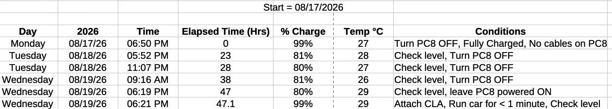

Well that is interesting. Evidently my PC8 is not the only LiFeP04 battery that self discharges over time.

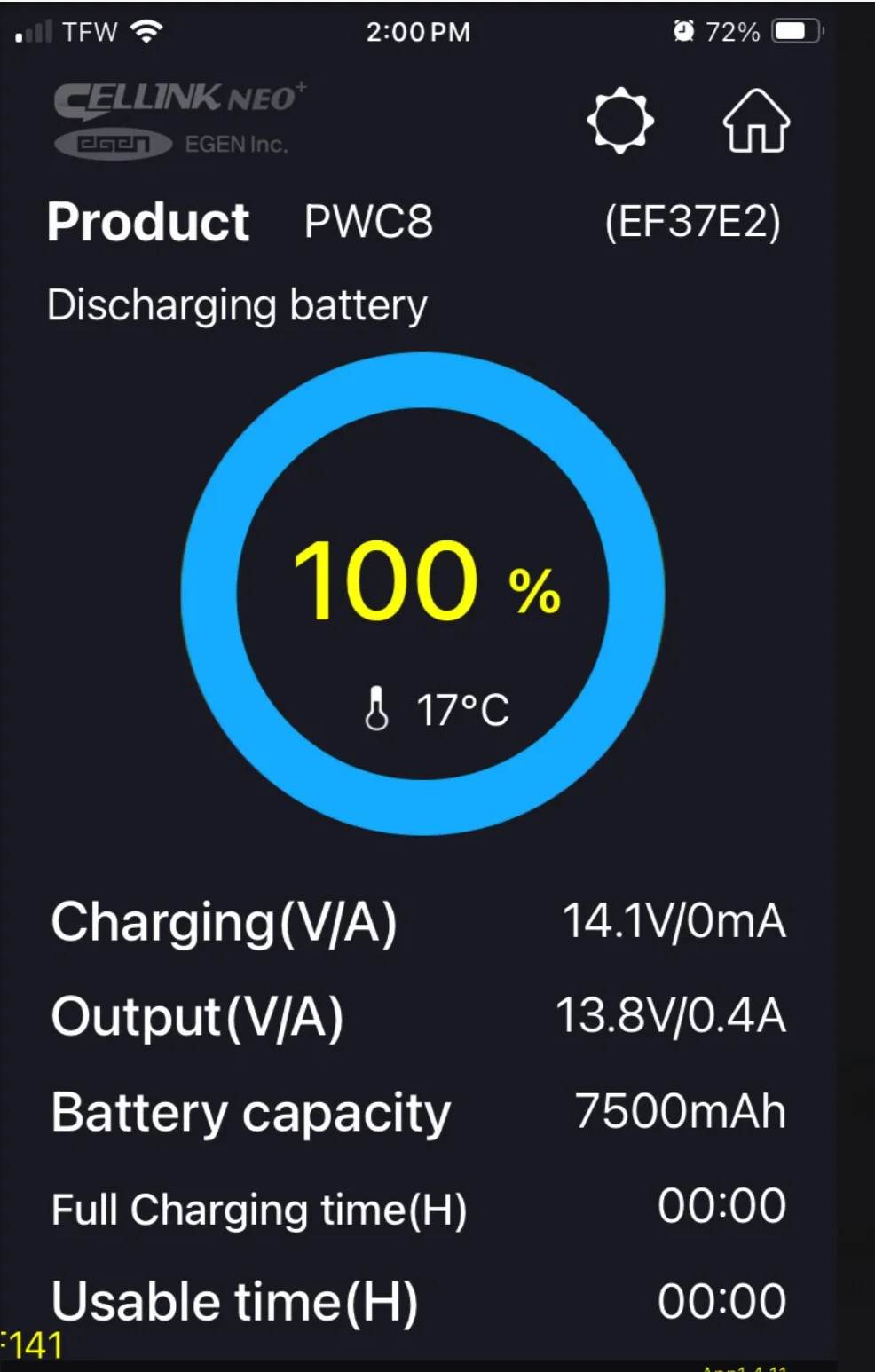

My first several days with a standby mode not enabled on the camera the battery was at either 99 or 100. The app reported a load at 63 mA, which I'm assuming is the LTE module.
What exactly was the powered state of your camera when your PC8 app reported 63 mA? You said the app reported 63 mA but said standby mode was "not enabled" which I took to mean the camera was completely powered off since you said the battery stayed at 99 or 100 after several days.
Without standby mode enabled, the camera powers off when the vehicle is turned off. The LTE module is separate from the camera in the Vantrue system.
I'm surprised the PC8 held at 99 or 100% after several days when the LTE module consumed 63 mA which is 0.325 W in a 5V system.
In three days (72 hours) that would be 23 Wh. The battery is rated at 96 Wh, so I would have expected it to decline to 76%.
I drive the car every day and every morning it is 99 to 100.
