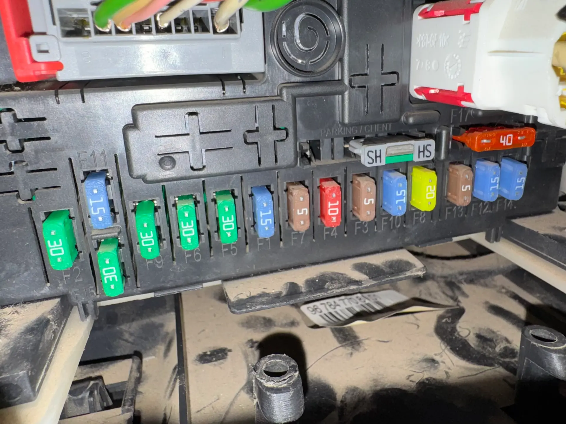

Hi! I’m currently having an issue with my Citroen Berlingo 2012, where due to the design of the fuse box and also the fuse taps, they won’t fit.
The fuse connections have a plastic portion right in the middle (see pics) and even if that wasn’t there, it still wouldn’t fit due to the taps hitting the other fuses on the sides.
