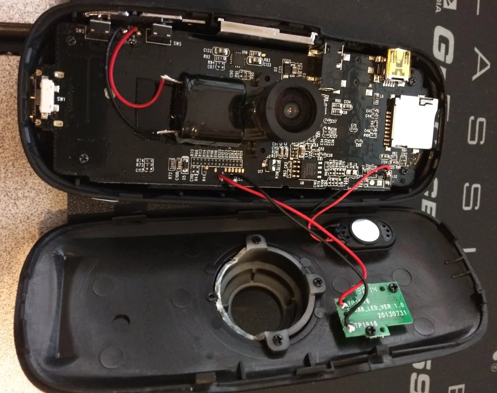

You might be able to use high capacity supercaps to power the camera but they will be too big to fit inside the G1W housing. The solution is to mount them outside the camera. See THIS thread for photos and an explanation of what I am talking about.

Sorry to resurrect an old thread but we have two of these G1W cameras and both batteries have had it. It seems a shame binning them and having to buy replacement cameras. I'm pretty good at soldering and would like to have a shot at replacing the batteries for capacitors and then flash the firmware so the camera shuts off properly.

I went to Maplins as lunch time and the chap behind the counter got all the potential capacitors out and I tested each one in the case. The only one which was any good was the 5V 1.5F Capacitor so I decided to chance it.
I've removed the old battery, and soldered the cap in place, I then flashed the following firmware onto it : G1WC_2016.1021.11AM_12mbps (if anyone wants this I can attach it) and hey presto I now appear to have a fully functioning G1W converted dashcam that reacts exactly the same as my Mums G1W-C camera!
Saved myself Β£35 on having to buy another camera so I really appreciate it.
