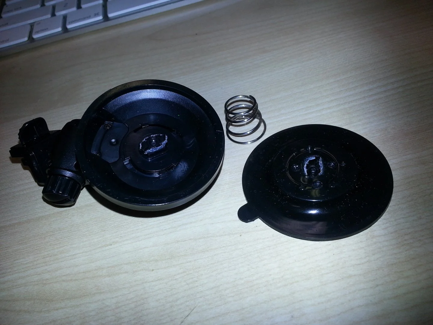

Separately however, the suction cap has broken away from the mount, making it currently unusable.
I've started to flag this Dome G90 as an 'entry level' dashcam only, before moving onto a better unit. Superglue might fix my issue, though really it should be necessary!

As for the mount they're not great - maybe get one of the alternatives from here:
https://dashcamtalk.com/forum/threads/the-g90-mount-is-rubbish-what-alternatives-have-we-got.7025/
I had a comment from someone at Dome one one of my videos saying they make the best dashcams - they should focus on improving the mount before adding any more software bells and whistles if they ever want to be able to say things like that :) They're obviously working to a cost but the mount is one of the most critical parts of a dashcam.
Oddly enough one of the Dome reps was extolling the virtues of this model on another forum and I politely suggested that the model had potential but they really needed to do something about improving the mount, he was quite offended and told me how much positive feedback they get about the mount they use and wouldn't have a word of it
as they say, you can lead a horse to water ........
Reverend thanks for the heads up on alternatives; just what I need.
As for Dome; right now they're intent on me sending them the broken part... for "repairs"... when it's clearly unrepairable. ie: it's a replacement mount and / or parts, not a repair. Including me shipping them the entire (broken) bracket... for "repairs". Really silly, when in reality it's an a) throw the broken one in the bin, b) send me their $2 bracket replacement under their warranty.
