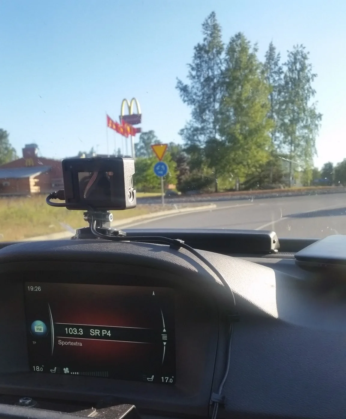

As you all know i have been running 14 git1´s as a dashcam in different vehicles and my conclusions so far is:
Making this post just beacuse not to forget this part of the forum were it is a bit silent
Dashboard mounted.
GoPro open frame housing
360 degrees rotation mount.
Lins protection UV filter.
All settings to defualt, but WDR is set to ON, car auto start and screen saver set to ON.
The heat during this summer (in shade) have been around 23-26c here and all the git1´s is doing fine beside:
1 camera came with RAM problems and have been sent tho the supplier for guarantee replacement. As mentioned in another thread, when i put carlicensenum.txt the video freeze as soon as the recording started, and this camera also lost date and time settings.
1 camera had bad battery from start. The problem that occured: Flickering screen and shutdown of the camera instantly in car autostart mode. Fixed with a new battery.
1 camera had a gap between the battery and the batterylock, problem that occured: it started to make a long beep but the screen showed live video, fixed with some paper between the battery and the hatch to fix the gap.
All cameras hade a china brand memorycard named LD 16gb class 10. All this have been replaced due "cluster size error blue screen erorr occured to.
Running just fine with Kingston class 10 16gb and Sandisk Ultra Class 10 16gb.
And i also give thumbs up for @gitup for good software support who helped me out with the cameras for my company.
I hope the cameras will run smoothly in the future! I will make a new conclusion when the winter is coming and then here we will get around -10c
