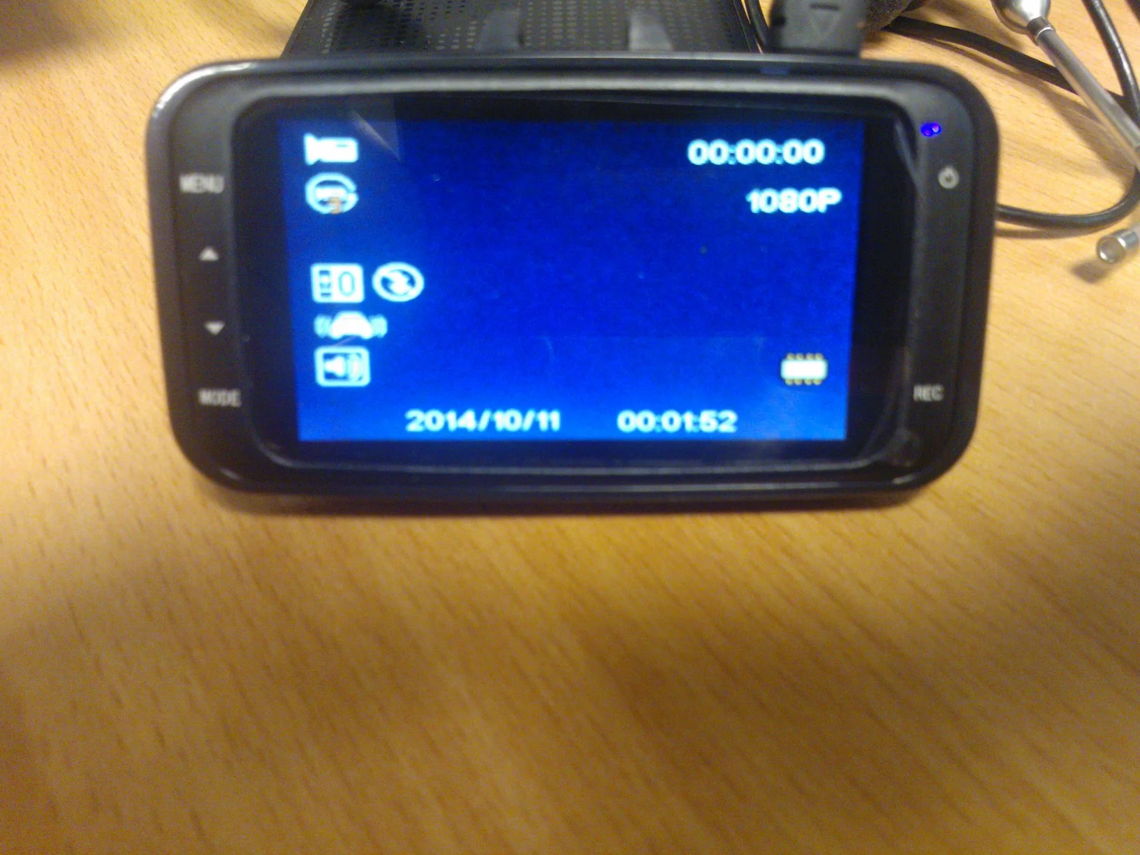

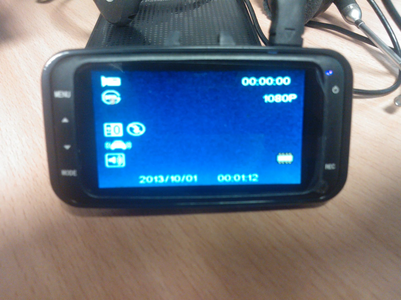

This is the screen shots
1. thats a camera just out of the box never used

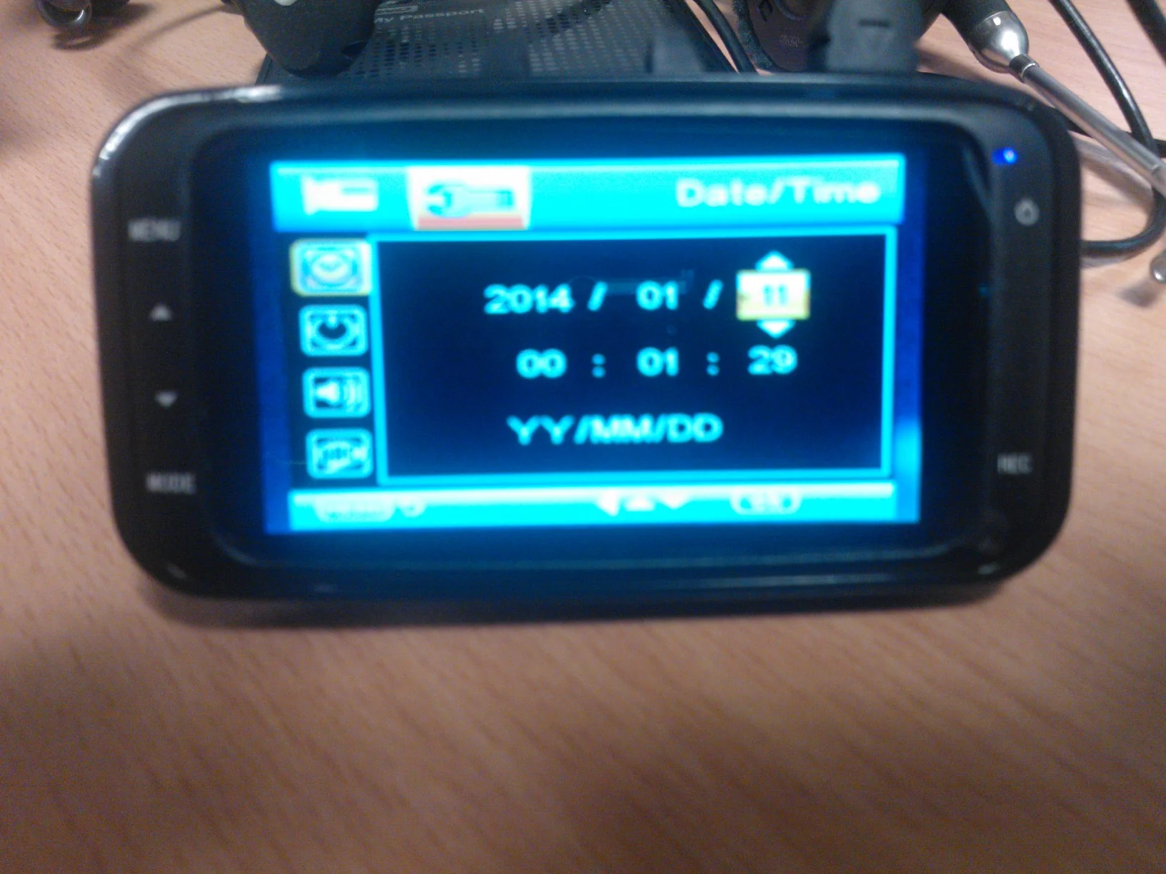

2. Setting date
3. After saving new date (year and day changed month jumps back to 10)

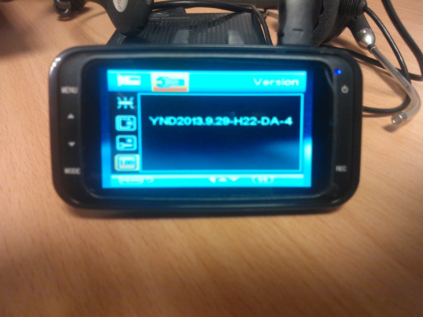

4. Version
this is a Novatek version, firmware version you're trying would be the Ambarella version, speak to your reseller about an update for your version
