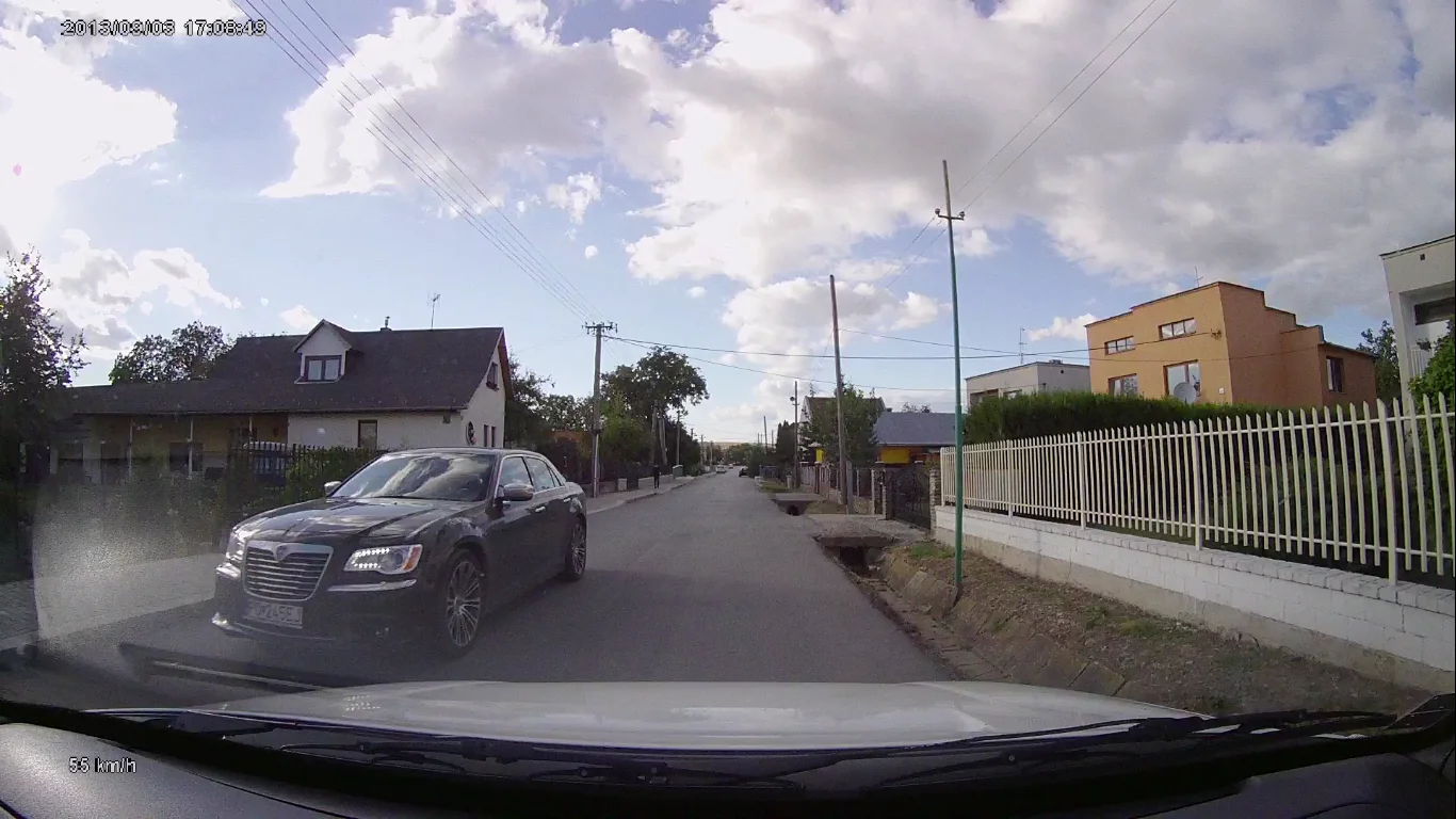

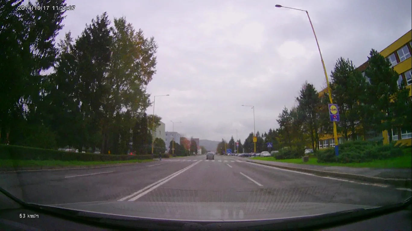

The first GS9000 was OK until it broke down. Video was extremely clear and sharp. But the second one has problem. It has sharp image only with sunny weather - there must be very big amount of light. When it is foggy / rainy or when is sunset / evening / night the picture is pretty fuzzy and out of focus. I remember that the old one made perfect and sharp video despite lower light conditions.
You can see the difference in attachments below.
Can FW update solve my problem? Or what do you think? Or am I only paranoid? o_O
Thank you.
for focus issues, the lens could be out of focus internally. this happens on some cameras from these Chinese factories.
you can attempt to disassemble and focus it yourself (there are posts on this forum about that).
or you can return for a replacement.
may or may not be firmware related. most likely its shoddy QC.
