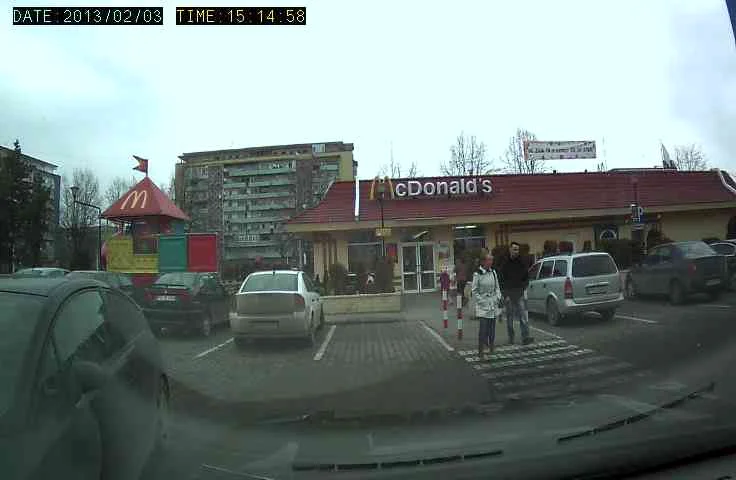

The McDonalds location was used for a test file regarding the wireless signal but I lost the recording. I will make it again. The video was showing that I can see live streaming from inside the McD.

The first video is set to private but the rest are fine. Like that the WiFi works for 50 meters. Nice for a surveillance.
Fixed the private thing. Sorry!

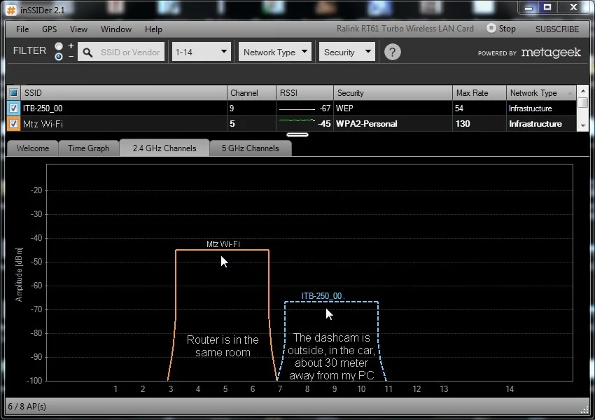

More screenshots about the wireless:
The Itronics ITB-250HD can offer FTP transferring because can work as FTP server. So any SO which can support FTP transfer can be connected to the 250HD.
