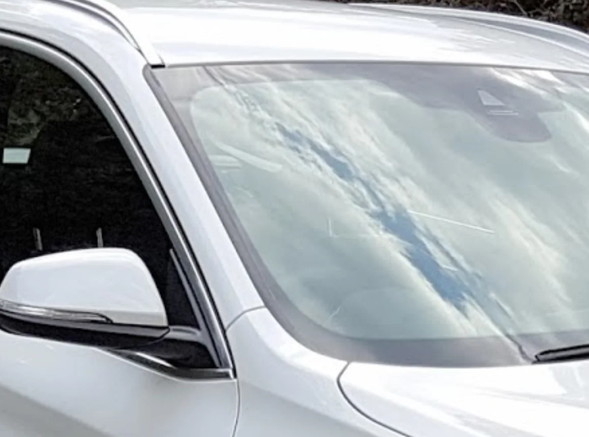

1/ I guess I can always cover the light if it is annoying.
2/ End Jan may be too late for me, unless I position top right of screen so I don't need to flip. Lock button is then easier to reach. Screen is quite tall so it would be well above head height...

It's a small LED, but sufficiently bright to see if you look. It doesn't project much light beyond the cam.
I think you'd be able to see it in the RVM without distraction.
Cam will be forward facing, above head height, to the right. Light doesn't sound like a worry.

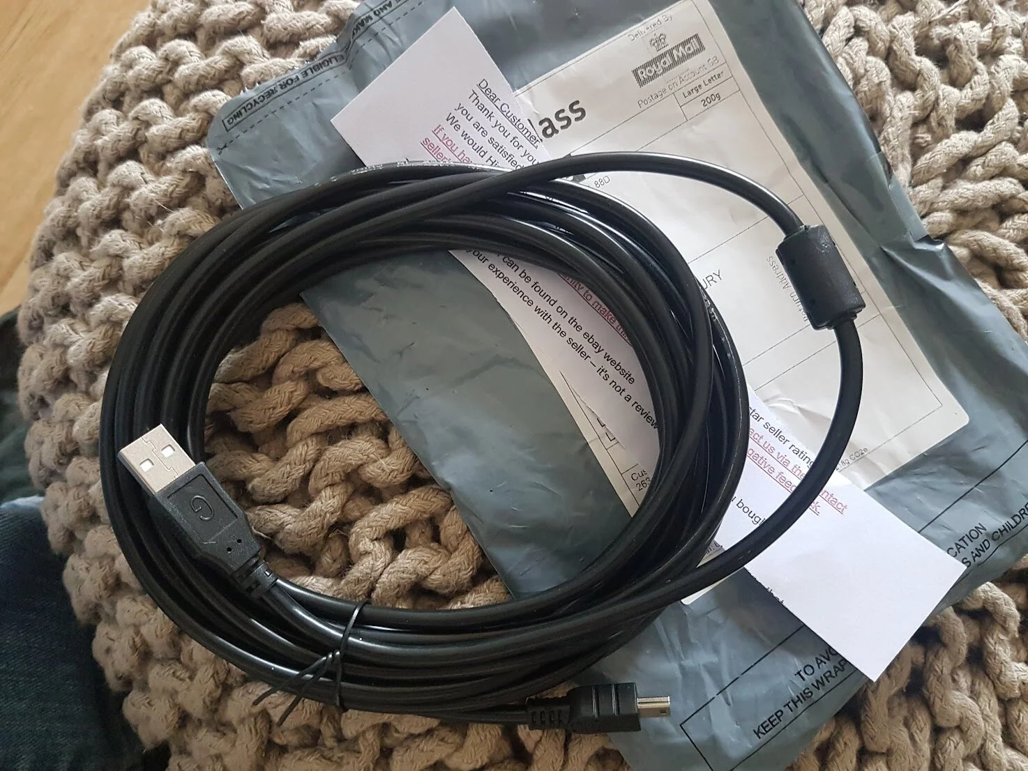

Anyhow, my wife's A119 is going into her new car but the 4 metre Viofo supplied cable is 1m too short for the route it needs to take (no under dash 12v socket).
I bought a 5m cable off eBay but it has two things wrong: 1/ It's too thick and 2/ it has an inline suppressor fitted near the USB A end which wasn't shown in the ad. This won't fit behind local trim...
So... any suggestions as to where's best for a thinnish 5m USB A to Mini-B cable?

May want to consider upgrading to the current model cam. A119 Mini 2. It is LIGHT YEARS better than the older models, especially at night. Uses USB C now as well (more easy to find cable)
I recently replaced my still going strong A119 V1 cam, well worth the upgrade. Sony Starvis 2 sensor is amazing!
But as far as cabling, where else to buy odd length cables, Amazon.
But keep in mind, if u need to too long length, you need to use a Active cable or a shorter Active Extension cable, then a normal cable. There is voltage drop after certain length of normal cable.
Presumably you have the cable pluged into a cigar lighter socket, in which case, how about using the original cable together with a cigar lighter extension cable?
From your complaint about the inductor, that may not be possible, but from an electrical point of view it is a better solution.
I had another look today... I found a different route which the original 4m cable suits, along top of screen, down the A pillar, under the dash, backwards along/under the bottom of the centre console, into the lower of the rear (of the centre console) passenger central USB 'A' double socket. Checked it goes off after around 30 mins from ignition off. It does. (Porsche Macan S). Previously I had the route going down to the floor, along the door, under the front seat which used another 6-700mm of cable. New route is better hidden too.
