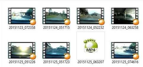

2, I'm sorry I should have made it plainer, It doesn't seem to matter whether I try to play the file from the memory card or from the HDD I cannot get files that do not show the initial image to play (see attachment), and before you ask yes, I waited about ten minutes to make sure everything was downloaded....of the eight files shown the seventh one asks me to change the codec.

are you formatting the card FAT32?
The latest firmware of the Panorama S allows you to format any size SD card in the camera. (native exFAT support) Try formating it in the camera, the instruction booklet is outdated.

IIRC it is fat 32 although the last time I formatted was about five weeks ago, I will give the formatting in the camera a try next time
