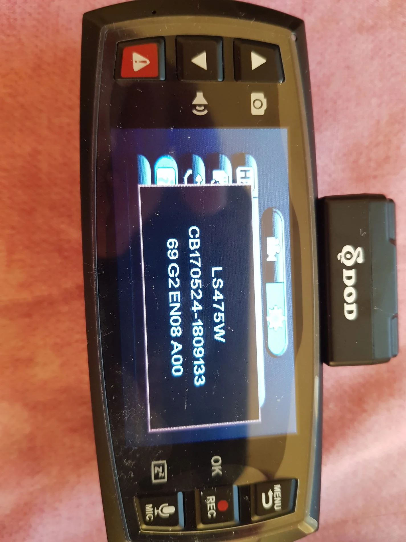

Hi there I recently purchased a DOD ls475w. I am in Australia and I do not know how to check what is listed on the website as being the latest firmware compared to my current firmware for me this is all a little bit confusing.
I have attached a picture to this message of my current version but I am unsure whether there are other versions on the website which are later than my current one. Would somebody be able to check this for me please?

Hi, yes, your DOD firmware is 1809133, it is more recent than it is on the DOD website.
Don't let that confuse you, it's just that the company's DOD policy on firmware is a bit strange - they don't post the latest firmware on their website. With this fact you just need to accept :)

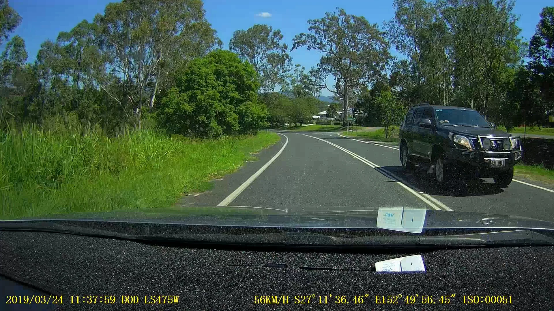

If you can place here a link to a small fragment (no more than 100 MB) of the original video, first upload it to the cloud service, then we will be able to give some recommendations. And what exactly do you dislike?
General settings: exposure compensation (EV) of "0" or "minus", recording resolution 1920x1080 30 fps. And yet - the DOD has a very sensitive sensor and the horizon line on the video greatly influences the automatic choice of the exposure. Such an installation is more often used: no more than 1/3 of the picture above the horizon occupies the sky

Yes. Large file, almost 500 MB ...
Everything is not so bad, although in the dark at 60 fps there will be blurry images.
