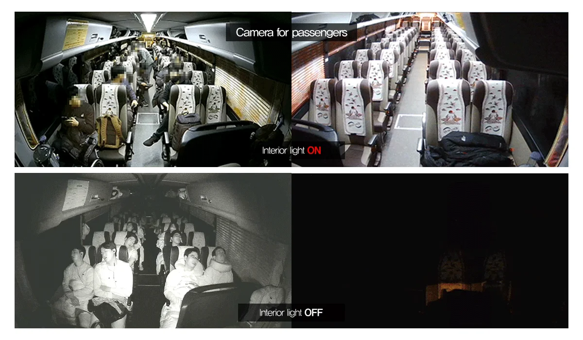

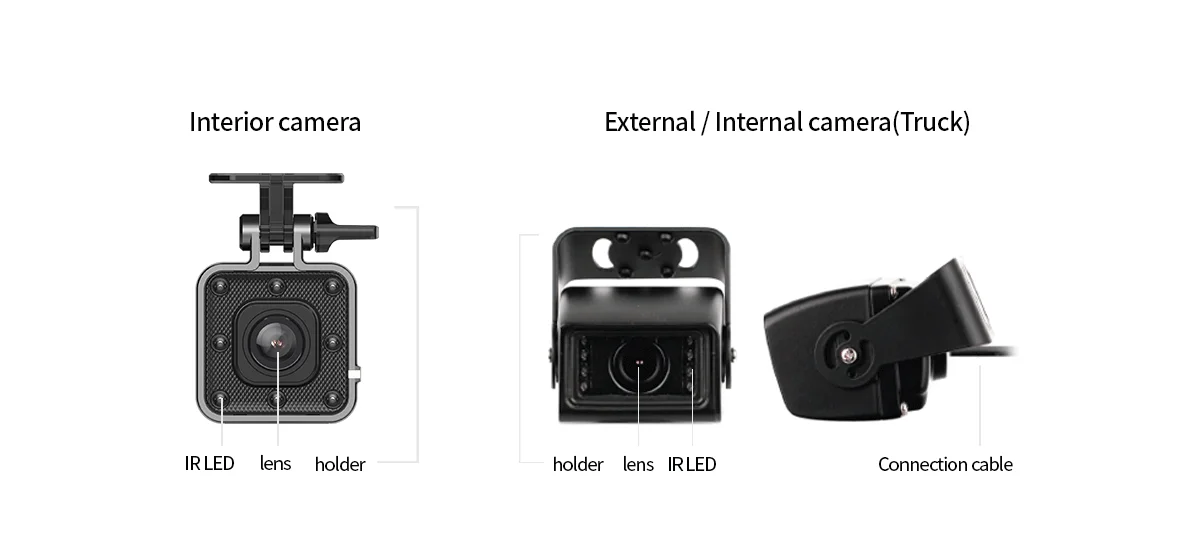

Some dash cam provides interior/rear camera with IR LED. Especially, interior camera IR is very practical as it shows inner view of a car. Providing important evidence when something happens. For Taxies and buses, interior cameras are important as it records actions inside of the car.
IR illumination at the cam inside of a car will reflect off the glass, almost eliminating the outside view. It does help with the view inside the car. This is something to be aware of if you are using parking mode at night and wanting the interior cam to 'see' outside the car.
