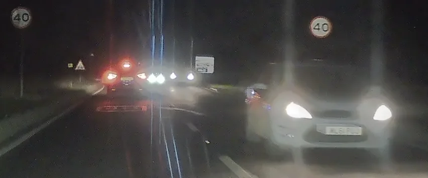

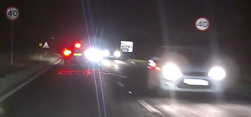

I recently bought a Viofo A139 Pro and I soon realised that I was not getting the same results as other people with the same camera.

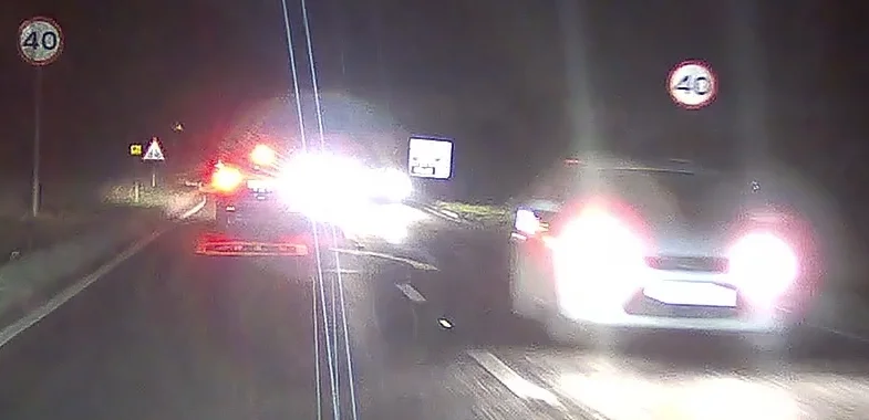

@Mtz captured this image at a vehicle closing speed of ~200km/h
a139-pro-4k-hdr-night-dashcam-speed-100-kmph-total-speed-200-kmph-zoom-5x-png.62257

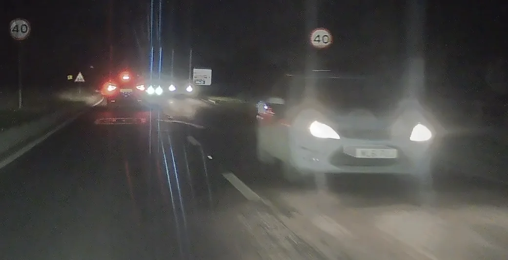

By comparison this is one of my best captures at 40+40 = 80mph = 130km/h
There are many factors that could explain the difference in contrast and number plate definition, including:

I think the main difference there is your beam pattern. In Mtz's image, his LED headlamps are reflecting light off the plate, in your image your headlamps are avoiding putting light on the plate in order to not blind the driver of the other car. LED lamps have more accurate beams and can auto-level almost instantly so can be aimed much better.
Possibly your headlamp beams could be adjusted to aim higher without failing the MOT test.
Aftermarket LED lamps are unlikely to have good beam patterns.
There may have been a HID headlamp option for your vehicle which would give out a lot more light, I'm not sure how much they help with the beam pattern though.
You can get the mirror surfaces in your headlamps refurbished, which could make a big difference on old headlamps:
Also possible to do a DIY restoration, but opening up your headlamp units is serious DIY!
In my experience we have no chance of getting such number plate captures in the UK. Our plates appear to be far more reflective than other countries. I have LED headlights and they wash out oncoming front white plates giving just a bright white rectangle.
Does the legal limit on headlight brightness & light pattern vary around the world?
I think Mtz has the same EU based rules as us, however his car will have a dynamic leveling system for the headlamps, which means he is allowed much brighter headlamps than your old car is. Just putting LED headlamps in yours would probably be an instant MOT failure. Not sure on the regulations for beam pattern and if that is affected by having a dynamic leveling system.
They will wash out with any dashcam other than the A139 Pro!
My car has auto levelling headlamps so I can't adjust them myself - I know because the levelling sensor was fixed to pass the MOT, in addition to cleaning the headlamps. It was an expensive service for an old car.

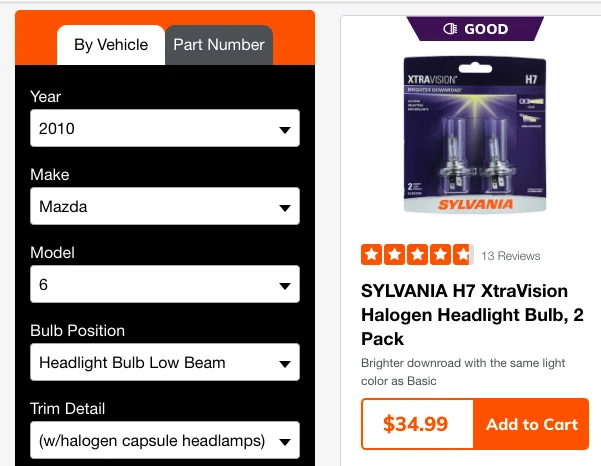

My car is a 2010 Mazda 6 Sport 2.2d
Stock web image:

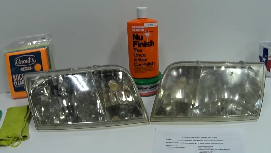

Can't tell much from the picture but if they still look bad or not to your satisfaction, I would try this product below:
https://www.amazon.com/gp/B00429NKWK
Not sure if this product is sold on your side of the Atlantic (either Amazon or a physical store). I used it on my previous '09 Honda Accord back in 2019 and it worked wonders.
Sylvania Headlight Restoration Kit ($21)
The Sylvania Headlight Restoration Kit provided the greatest improvement in illumination and appearance with no noticeable degradation over time. It involves a total of six steps, including progressively finer grades of emery paper, rinsing, and a final coat of UV-blocking polymer coating that is best applied with rubber gloves and in a well-ventilated area. Applied entirely by hand, it reduces the risk of damage to surrounding paint. The Sylvania sanding papers are larger than those included with some other products, making them easier to use, but the best results do require some effort.
Consumer Reports’ Take
All the headlight restoration kits worked to some degree on at least some headlights, but only the Sylvania could be used with all tested lenses. Further, the Sylvania product also provided the best and longest-lasting results. 3M provides similar performance at a lower price, but it carries the risk of scratching painted surfaces abutting headlights and should only be used by those comfortable with using power tools. Turtle Wax is the bargain-basement product of the bunch, at less than half the cost of the top-performing Sylvania. But neither Turtle Wax nor Fast Brite lasted as long as the others.
Video instructions:

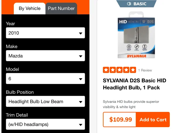

According to the Sylvania bulb guide the 2010 Mazda 6 uses H7 halogen bulbs, or an optional HID D2S. If you had the optional HID’s I don’t think you would be complaining about light output, (unless both HID’s have malfunctioned).

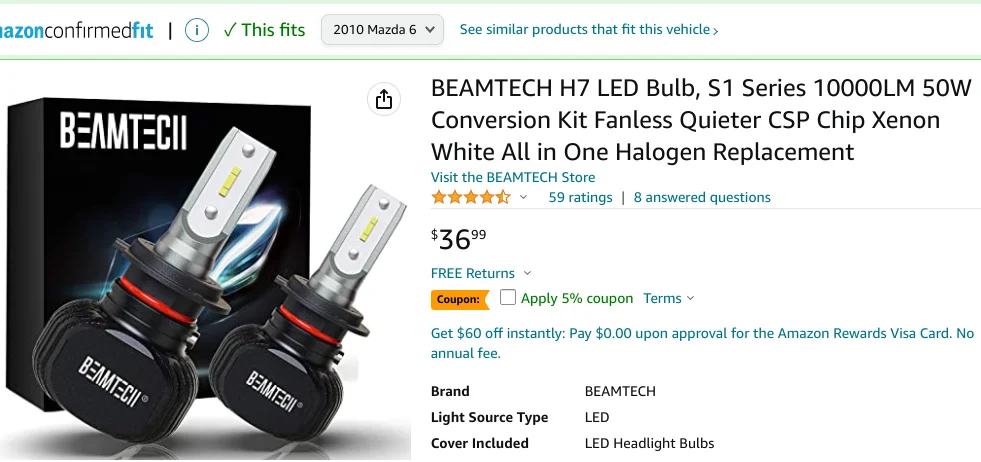

I would try these Beamtech H7’s for $37.
I have the same pair in H13 size installed in my 2010 Mercury Grand Marquis, (I have 2 cars). Here is a before & after with the halogens on my car;
