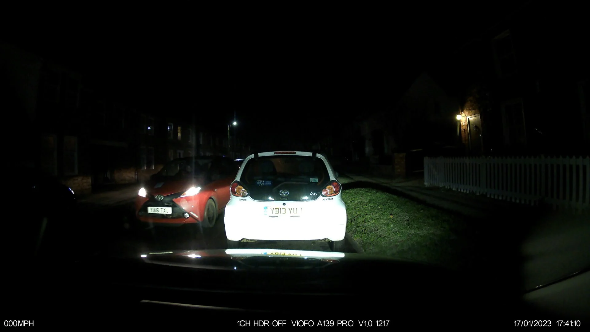

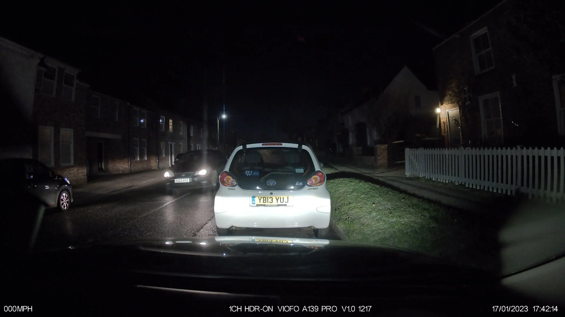

HDR ON and OFF with the new bulbs. These are not a drastic improvement, but I do see a noticeable difference with a more clearly defined cut-off than before, and a higher proportion of number plates are now readable at night (y)
Further testing required to see how they perform in different situations, however I will probably use the HDR timer function to only use HDR at night.
Sample video with the new Osram Nightbreakers. I can definitely read a much higher percentage of oncoming number plates, driving at up to 50mph. Front plates are black-on-white so they have good contrast. The black-on-yellow rear number plates have less contrast so are harder to read, but I think it is not so important to read the plates on parked cars. Overall I think it's a fair improvement.
