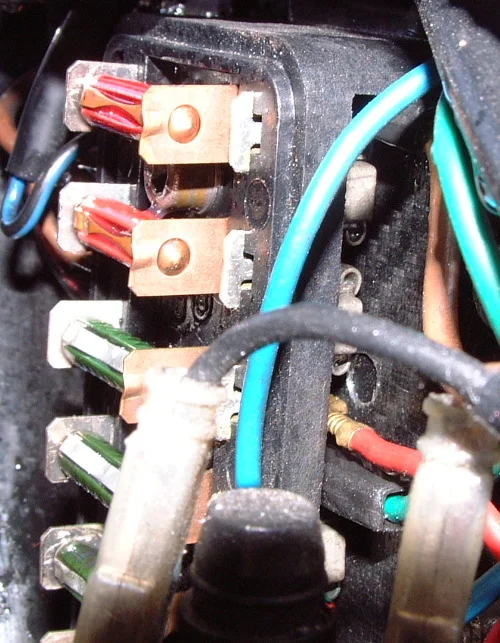

For example - This is the fusebox on a 1979 Moto-Guzzi.
It's a simple choice of fuse as ALL fuses are switched.
If not then buy a CHEAP multimeter (eBay has loads in the USD20 range) and check fuse by fuse until you find a fuse that is only live with the ignition on.
imo you should not even go near electrics without one.
It's not THAT EASY to see but basically there are some FASTON tyre blades that will take a standard 1/4" faston female terminal.
If there are none free (and in this case there are none) then there are solutions - don't panic.
There are piggy back faston adapters and terminals.
Which type you choose may depend on availability and space.

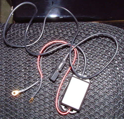

I have used a fair few hardwire 12V->USB adapers - here's one with a mini-USB (and 90ΒΊ adapter) that was rewired with ring terminals to fit my fuseboxes.
But we'd have to wait for RockThinking to prepare one due to the non standard plug - My eyes are not up to soldering micro-USB connectors.

You are doing good work, but to be very honest, I prefer to pay for lunch and beer to have someone to do for me, and hope this guy is really skilled.
Please give me sometime, I would like to change it back to standard plug, but not from C3.
