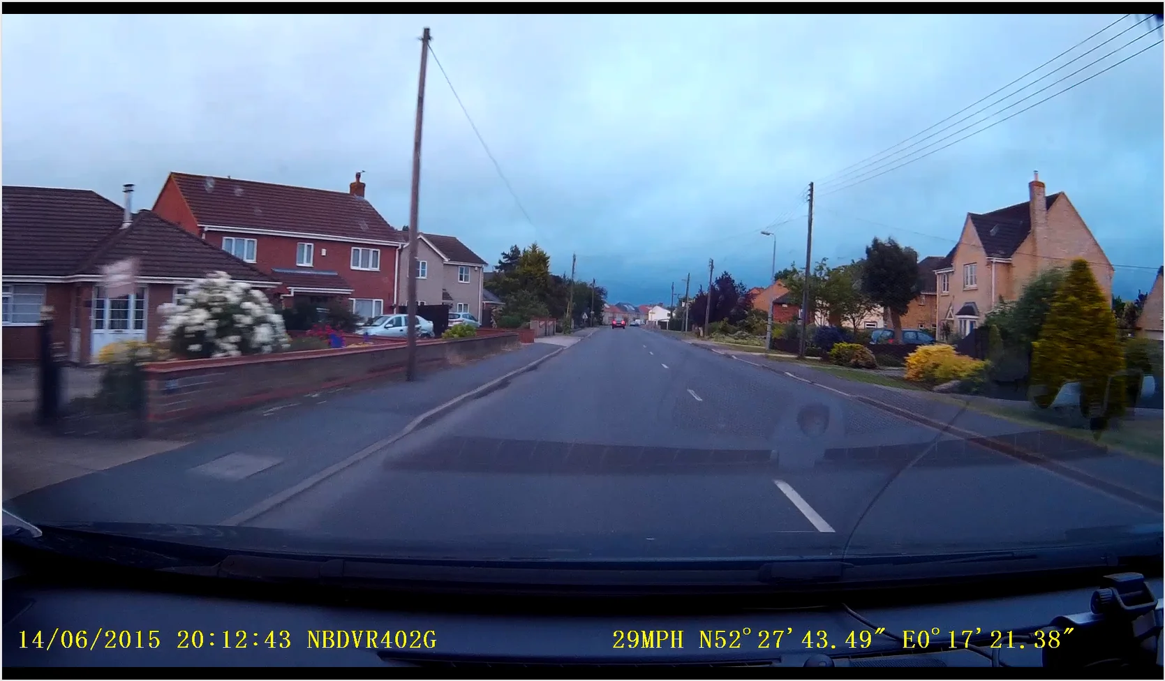

Hi all,
I don't recall ever having this issue with my previous vehicle and dashcam, but as you can see, I'm getting a reflection of the dashboard in my image.
The dashcam is tucked up as tight as possible to the top of the window, just under the rear view mirror. As you can see, it really affects the shot.
Any tricks that I'm not aware of? Attached image below.

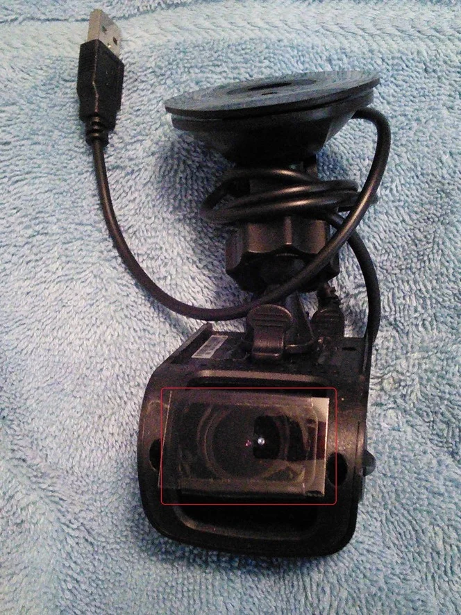

Ryan, I use a polarizing filter. Most dashcams do not have autofocus (that is, most are fixed focus), so all I need is a linear polarizing filter. (Manual focus and fixed-focus cameras do not require CPL or circular polarizers. I don't know why some people get hooked on CPL's.)
I bought a 6x6 inch sheet of transparent (vinyl?) linear polarizing filter through Amazon for about US$10-15. I can cut-to-fit and very cheaply replace this material. This item is probably also available at science or educational supply stores.) I cut a piece down to fit the outer lens bezel or some part of the camera housing. (A 6x6 inch piece should last a long time.)
I use it on some dashcams and some security cams, but only if necessary. I used simple, inexpensive vinyl electrical tape to affix the filter to my A118c, for example. The tape that I have comes off easily and hasn't been messy. (Other tapes have been messy!) I make sure that the polarizing material does not come into contact with the lens element.
Another dashcam that I have has a round outer lens bezel, so I affixed the filter to a small, inexpensive rubber gasket. I don't see any impairment on my images, but do remember that although the material scratches easily, it's extremely inexpensive to cut off another fresh piece and replace it. I replace the tape every couple weeks.
NOTE: Before I cut my piece, I rotate the piece while viewing through it through my windshield to know how to orient the piece to obtain optimum glare reduction. I use that orientation or position when I affix it to my camera.
Attached is a photo of my A118c with a polarizing filter that I have outlined in red.

I also think +1 exposure is a bit too much on this dashcam as it looks washed out and over exposed.
It's a dod ls360w. For some reason, I think my old ls300w had a sharper, better picture?

It does seem overexposed. It would probably help to turn down the EV setting incrementally until you're more happy with the image. Separately, I might also suggest that you tilt the camera down so that you have less sky and more hood in your FOV.

you can clearly see the whole picture is compromised by a cloudy haze and I assume you noticed that and not just the air vent reflection and thing in the middle..

looks like a Cpl or dash carpet but neither is a great solution ....

Be sure you clean your window with a non-ammonia based window cleaner. The cheap windex stuff will leave a haze that will refract light. My cleaner of choice is Invisible Glass.
My window is freshly cleaned. All of my images are like this.

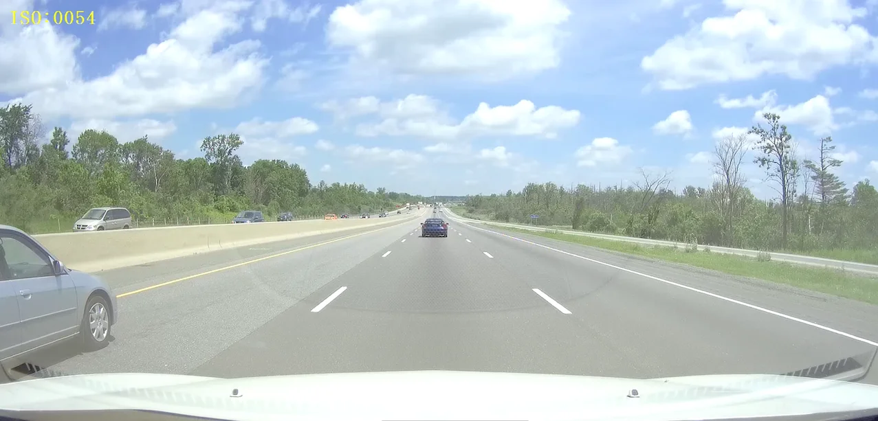

I tolerate reflections with cams mounted high (behind the mirror) because as I like to have two front cams (because various things can cause a cam not to record) I mount the second one low down, on the top of the dashboard, below the level of any reflections.
Pic attached - screen shot from one cam (Nextbase 402G) mounted behind the mirror, showing the other cam (Cobra 840) in the bottom right corner of its field of view, mounted to the dashboard.
