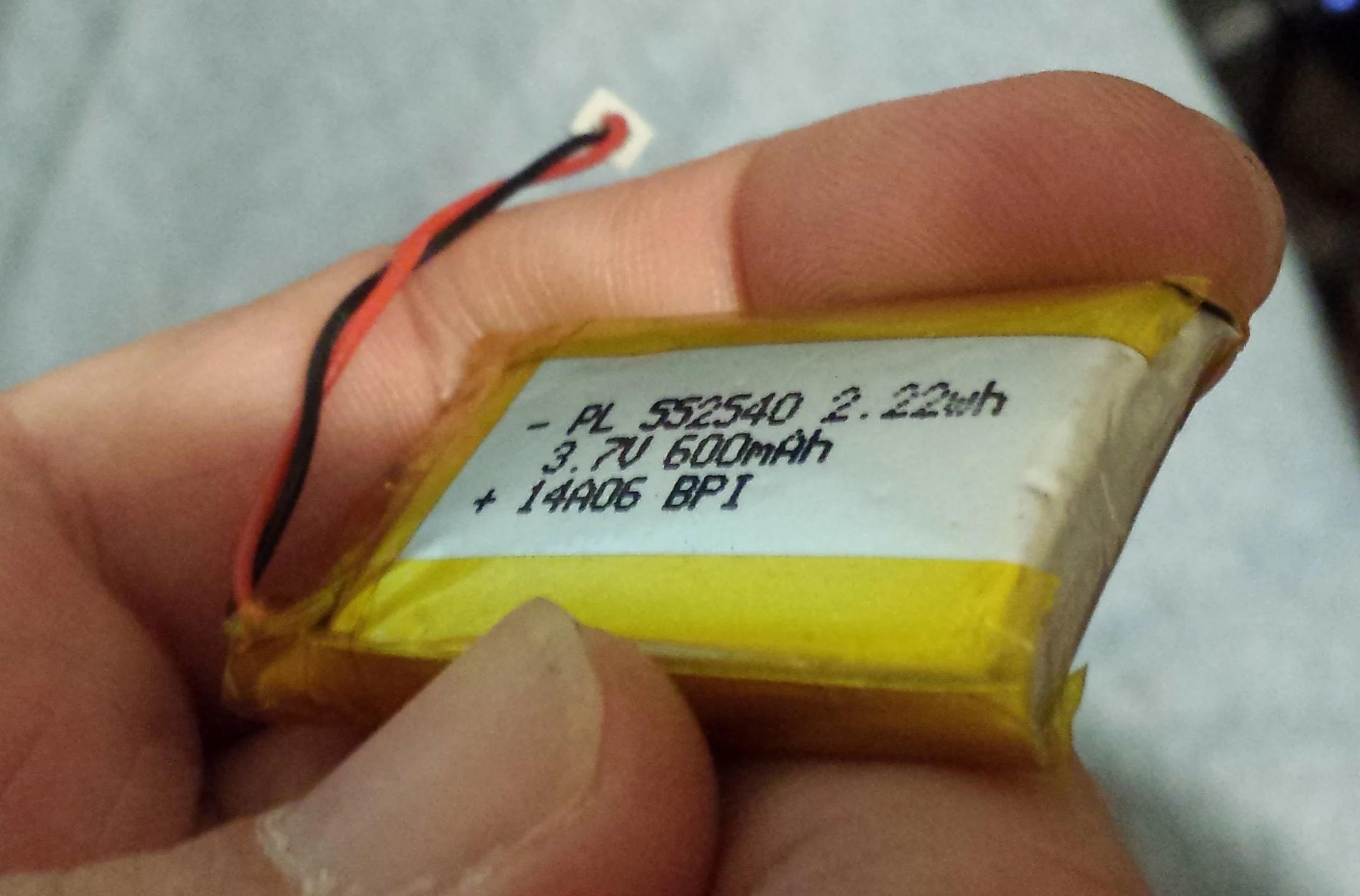

I bought 2 Innovv C3 cameras for my motorcycle about a year ago.
Well after some recording issues I just noticed (lines and weird artifacts in the device), I swapped them around; memory cards and the second unit works fine on both lenses. After taking the problematic one apart, i found a completely swollen and about to explode battery. That would have been great to leak acid all over my wiring harness and ABS system.
BATTERY VS CAPACITOR IS A VERY BIG DEAL IN A STATE WITH 100F+ TEMPS.
