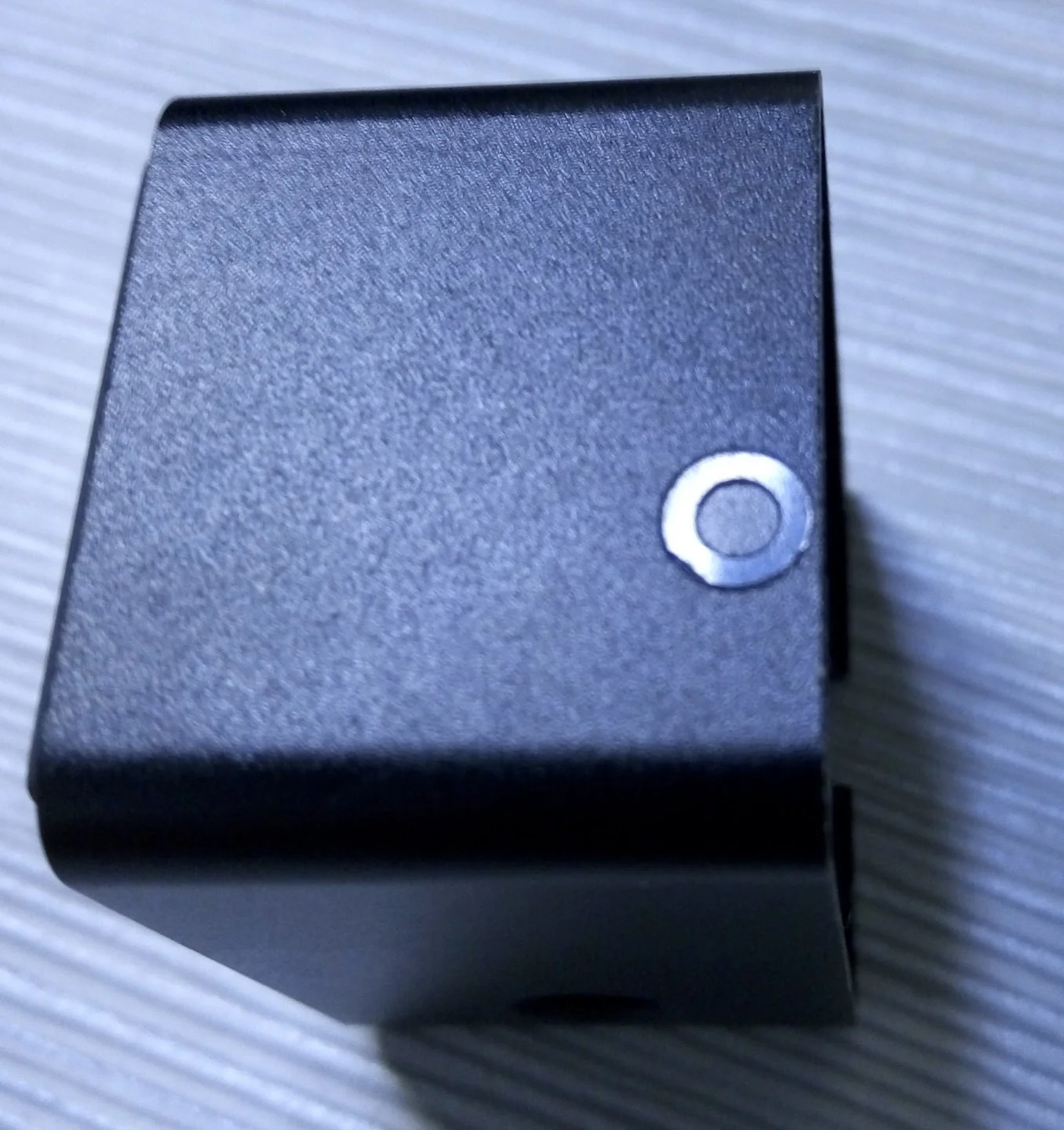

Indeed, now we are working on improvement, you can see below,
A mic hole made on case that is top of Mic in PCBA, and a film is to cover the hole that can get audio through but waterproof. Mic hole on case.jpg

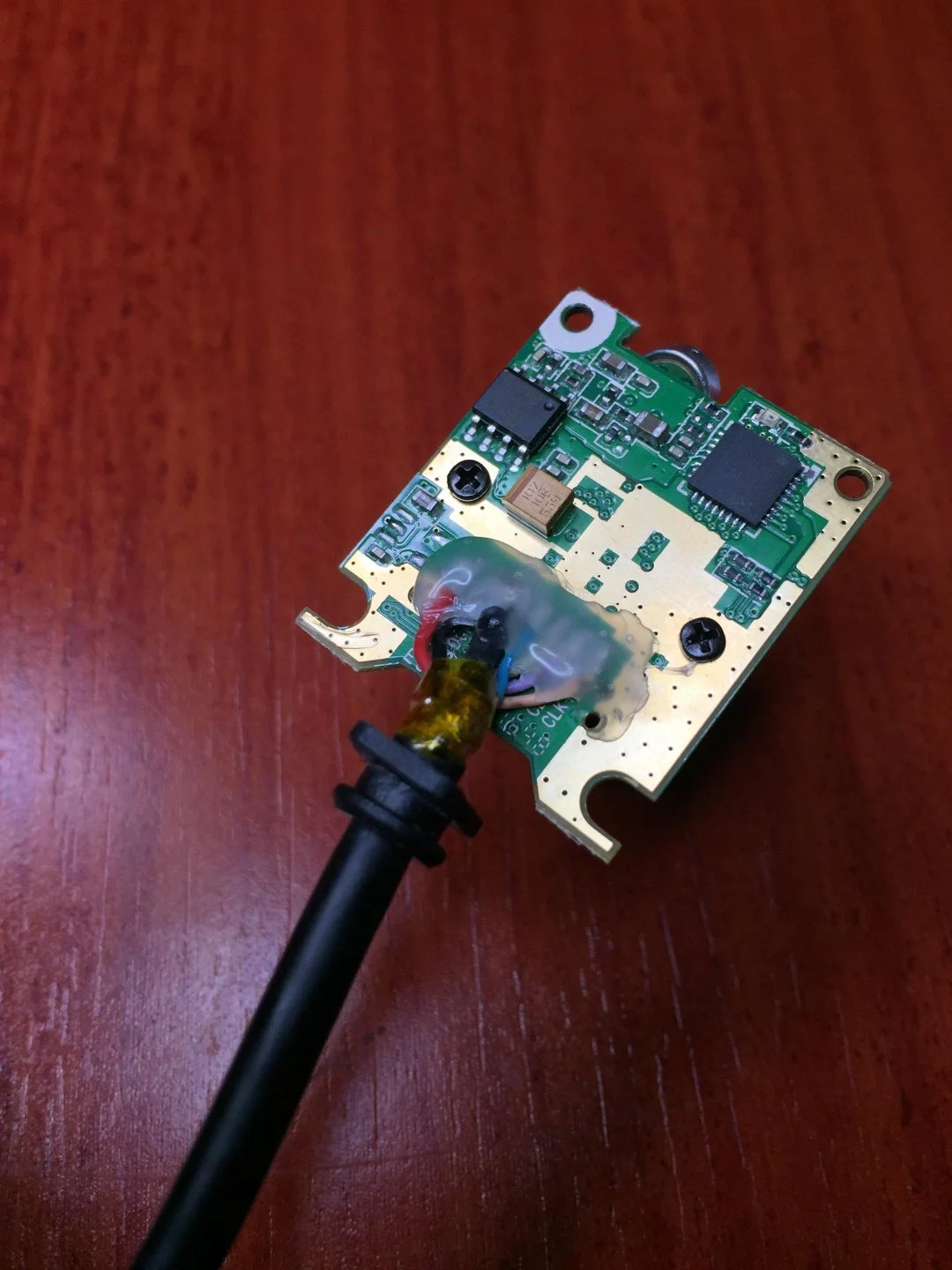

As you can see the improvement we made, I can be sure, it get sounds if nothing is wrong.
Can you check below,
Do you mute the Mic? you can mute the sounds by press the middle button on DVR while recording, you need to re-press the button to un-mute the sounds.
You can see from below photo, the mic is on top of PCBA, to verify if has sound, you can screw off the back cover of front camera, and speak to the mic, check if has sounds.
If there is sounds, we can send you the improved case then you can replace the last one.

Hi Rock, I have a 3 wire jack socket I want to solder in for an external microphone on my K1s , the PCB Mic seems to have only 2 pins, which of the wires do I solder to the 2 pins? see photos.
