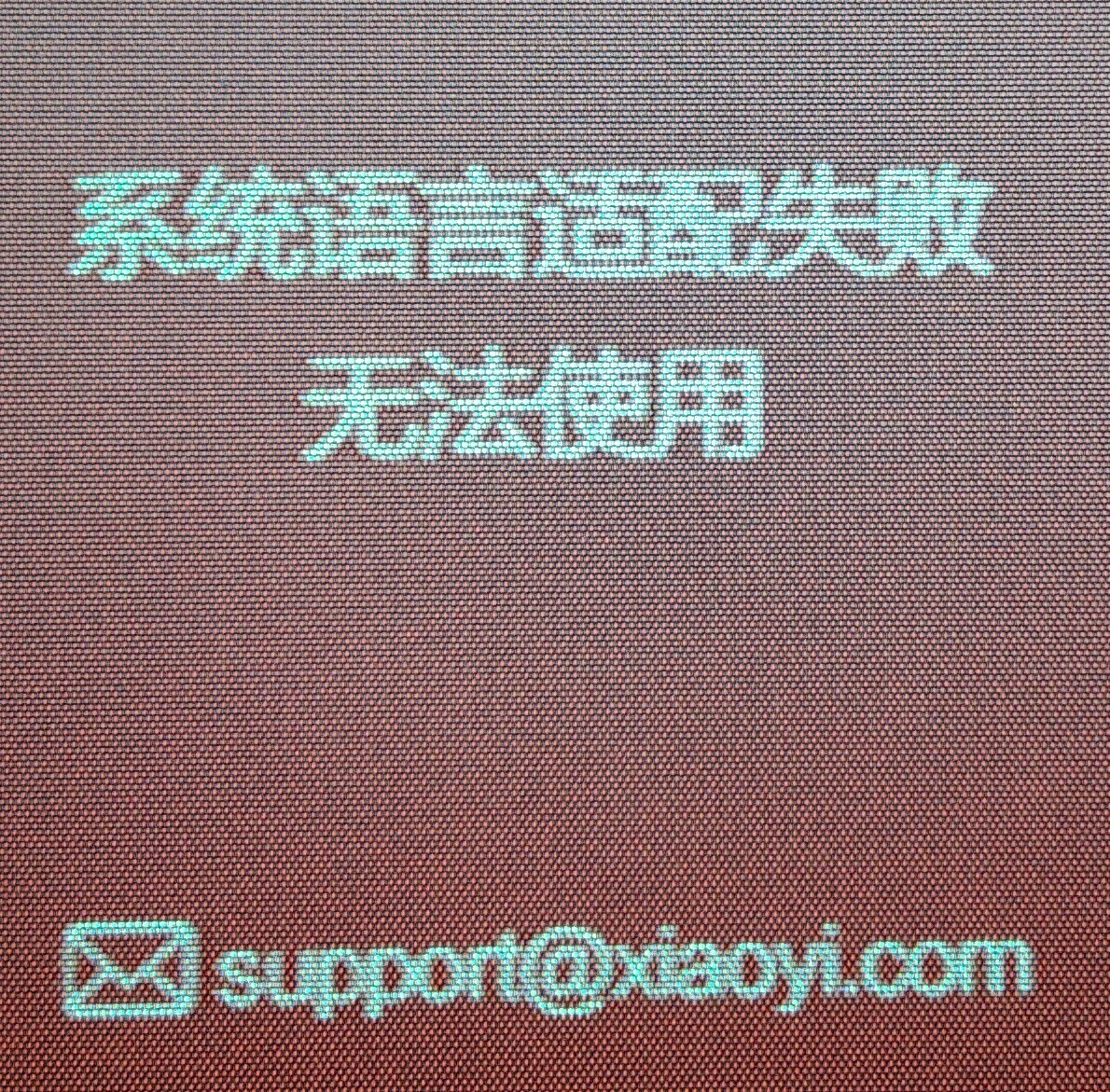

Dear All
My Yi Dash cam is stucked on " language adoptation error " as attached picture.
The camera is with latest version of Chinese firmware and I have tried to convert it to English by replacing first 14 characters of serial number with CN to US.
Please help me to restore my cam.
Thank you..

Hi were you able to sort out this problem..i too have faced the same issue..
Yes.. please let me know the error massage.
I got stucked when I try to chang the Chinese firmware to English. I replaced serial number CN to US as per described in this forum.
At this point you must flash English firmware. Chinese firmware not working..
i also tried to change to english and a blue screen appeared with the a serial number..there after this message was appearing..
its the exact same error shown in your image..i tried both the firmware bud doesnt seem to be working..what is your firmware version number..can you please post the firmware you used..
Thanks
I have the same ... anyone have any way?
i have!!!

Thanks but my camera was a different variant of black color..it had stripped down features from the original version..however i was able to get it reset using the UART power in the motherboard..
can you post a tutorial on how you do it? thanks. i also got the same error when i tried to update the firmware to english
+1 to the request. These new black versions are Chinese-only, so a way to turn them to English would be super helpful.

I followed this instruction and it worked, but I am stucked with the s/n.. i turned it off and restart but it always go to the blue screen.. I tried deleting the 3 files then it goes back to the language error.. please help
1. Use Micro SDcard class 10 (80MB/s)
2. Formart Micro SDcard to Fat32, 64kilobytes
Then follow instruction.
When cam display show s/n, remove SDcard, restart cam. Format sdcard befor insert in cam
If not success, pls post your S/N, i'll try on another cam same
I am using scandisk ultra 32 gb, I followed the instructions above.. formatted it already after the s/n, but after i restarted it, it goes back to the red screen language failed :(

I followed all your steps, but it still resulted to the pink screen.. after the display of s/n, i formatted the sd card and restarted the cam and then back to my original problem.. :( this is so frustrating.. please help..
I have tried to change to from US to CN but it only displayed Yi in red back ground
