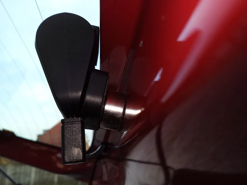

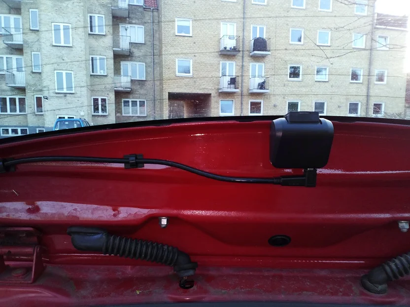

Bridging the gap on a rear hatch that swing up is no problem, but you will of course ned to have a little slack there, but nothing nasty.
I have for years mounted off the bare metal rear hatch using a magnet to space out the camera so it is right at the top of the rear window where there is viper coverage, and then guided cables to a side, where it then transition to the headliner near the C pillar.
Most brands also have a EXT rear cable offering if the default one is not long enough, this have never been a problem for me but of course i drive a almost micro JAP hatchback.
So i can even route down low and out back if i want to, but i have often draped cables along the side of headliner just in front of the curtain airbags as,,,,,, i dont care.
Be careful using build in USB plugs, they can be drastic underpowered, for sure be mindful of this if a system start to act erratic on such a power source, if that happen #1 option is to try the provided power source to verify that is the problem.
Pic of a rear camera 0n my rear hatch, close up pic.
